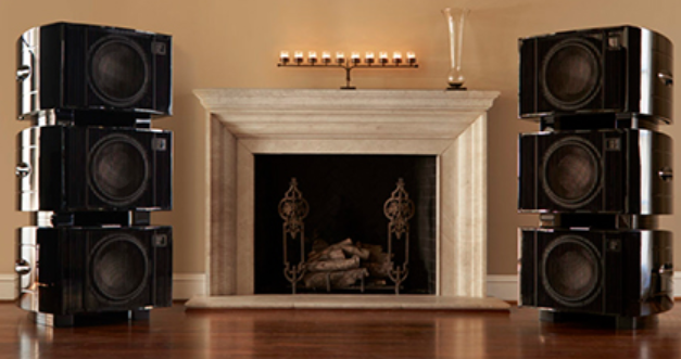

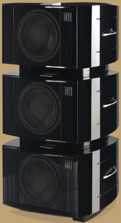

These RELs on the other hand...
This all fine and good, but where are the speakers?
Who needs speakers when you have subs like that? ;)
Sitting by the fireplace, admiring your subs all grouped around....photographers can have strange thoughts? Or are the speakers just widely spaced?
