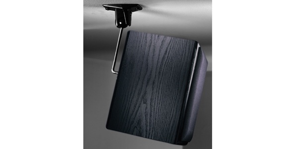

No. You can not do atmos with all in ceiling speakers. One of the reasons it works is the differential in height from the side surrounds/mains to the atmos speakers. IMO even regular surround implementation should not be done in ceiling either, but atmos will not be effective with all speakers in ceiling. As far as mounting surrounds, there are a couple ways to go for a standard setup where they’d be about 6’ off the ground. Omnimount makes some ceiling mounts that extend down from the ceiling. Or you could do the popular thing these days and use some iron pipe, and flanges, and fittings for a steampunk thing. For atmos, you’ll want the surround speakers just above ear height when seated, so regular floor stands would work there, and then mount the atmos speakers in the ceiling, or bookshelf’s on the ceiling. Upfiring modules are available, but they’re not as effective, and given the reflect nature of the room already, it will likely be a mess.
Or something like this, but for a speaker.
