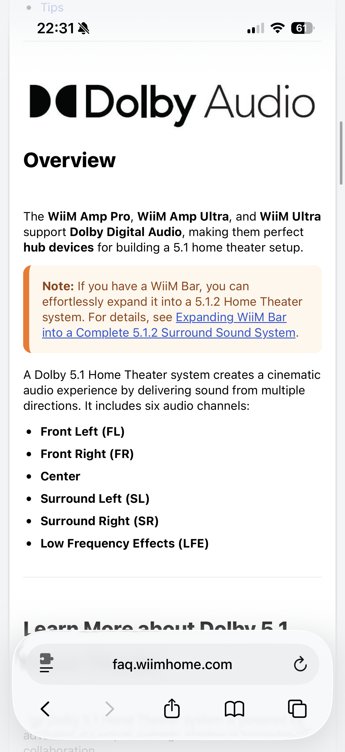

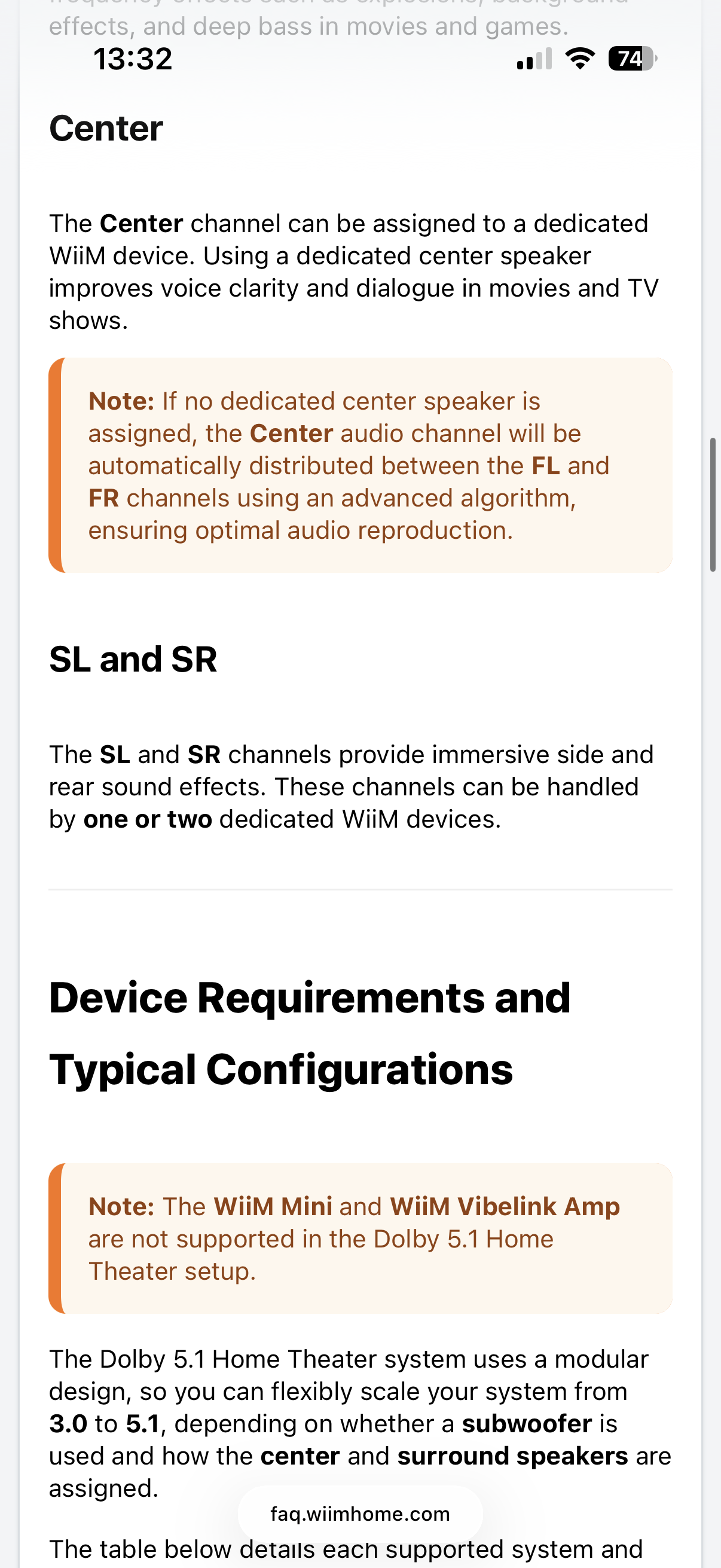

Yall should read up on the product before shitting all over it. The wiim sound lites are powered speakers that obviously work with the wiim ecosystem. The wiim amp ultra (along with a couple other devices) supports 5.1 ch Dolby digital. The OP isn’t just making this up lol

Phillip is correct. I won't get into an internet argument, but it works as a 4.1 system plain and simple.
I don't know exactly how the Wiim Amp Ultra does it, but it decodes AC3 Dolby and works in 5.1 (4.1 on my system).

The sound lite surrounds are on the same WIFI network as the Wiim Amp Ultra. The WAU powers the front mains the usual way with speaker cables. The WAU sends the rear surround information to the sound lite speakers through WIFI. Really simple and clever way to transmit data.
