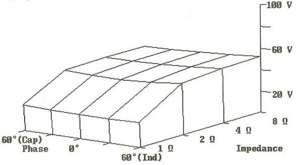

Steve, I am well aware of that without looking at such articles, but thanks. The factor is the cosine of the phase angle, cosine 60 degree is 0.5 so if the phase angle is that large, you get a factor of 2, similar effect to halving the impedance.
That's not exactly my understanding of the problem on the amplifier side, else a result like this wouldn't make much sense to me:
As you'll note, voltage output remains consistent across phase angles, even down to 1 ohm, where current limiting is obviously an issue. In the prior graph, voltage output sagged according to phase angle at the same ohm steps.
My understanding of the aforementioned equation (which could be full of BS, as I'm no electrical engineer) is that for a specified voltage output, power to the speaker will be reduced versus a load with no reactance, so you'll need to drive to a higher voltage and consequently current level to reach the same apparent power output. I'm open to ridicule if I'm full of crap.
So yes, if the large phase angles coincides with the impedance dips in the lower frequencies it could make that speaker power sounding not right in the hands of a weak amp but still matter much if the amp is outputting 1W. That's all I am saying.
Sorry, not sure what you referred to. Your diagram is not clear and I wouldn't want to guess.
I have listed the power formula on this forum many times in the last several years, most recently in my post#57; and here it is again:
Power (in watts)= Voltage (in volts) X Current (in amps) X cos (ø)
where ø is the phase angle between the current and voltage phasors (AKA vector), and cos (ø) is AKA power factor.
One could include a distortion factor as well but for all intents and purposes, P=VI cosø is close enough.
So you can understand if ø is 60 degree, since cosø = 0.5, power in watts would be halved for the same voltage and impedance (hence current), or if you want to maintain the same watts, the current has to increase by a factor of 2 (what I said in my previous post). Also, note that impedance is not in the equation, but it's effect is represented in the formula none the less since V=IZ (Z is impedance, that includes resistance R, inductive reactance 2лfL and capacitive reactance 1/2лfC).
I am, and the power formula is well know enough you don't need to be an EE to know anyway, very googleable as well as you know.
Correct, more or less what I said just in different words.
I understand, and would generally agree. Just trying to point out where some failures to communicate/discrepancies between these calcs and real world listening may come into play.
Agree, but not in the case where people claim even at 1 watt there are differences between amps. Well as you know I do question that kind of claims (not saying they are always false), but unless the amps in question are not well designed/entry level ones etc., defective, or there are something else at play, including Placebo, they shouldn't have trouble outputting 1W clean and relatively at very low distortion. At higher SPL and power requirements, yes some speakers, though relatively rare, could be problematic and I have never disputed such claims.
Just that some amplifiers can't maintain voltage output into loads of varying reactance. The amplifier's results I posted there clearly can handle a reactive load without a sag in voltage. The prior amplifier did sag in voltage output when the reactance went up. This shouldn't simply be a matter of current capability, given that the latter amplifier is getting limited into a one ohm load, but still maintains voltage across all phase angles.
Googling and gaining a strong understanding don't always equate unfortunately. I've read a little bit on the topic, but not enough to claim a huge amount of understanding; just enough to be dangerous :D
So you can understand if ø is 60 degree, and cosø = 0.5, power in watts would be halved, or if you want to maintain the same watts, the current has to increase by a factor of 2 (what I said in my previous post).
I guess this is one spot where I'm getting hung up. It doesn't seem like current has to increase by a factor of two, but the root of two, since you'll have to up voltage accordingly to get double the apparent power; ie if you're running 100wpc into 4 ohms, that's 20V and 5A; to compensate for the apparent power factor: 200wpc into 4 ohms is ~28V and ~7A.
Appreciate the thoughts. PS: don't know if you want to switch to PM, since this isn't exactly on topic :eek:
PENG
Yes, you are right about the root 2 factor, not 2 if impedance remains the same. My point was mainly on power in watts being halved if the phase angle is 60 degree. The rest of it was just meant to be a math illustration, that if V is held constant, current has to doube in that formula, remember I noted that impedance was not in that equation, but its effect was represented by V=IZ relationship. Current can double if impedance drops to half, without V increases again all just a math illustration, not intended to mean anything physical. To be honest, I do not know much about speakers so I am not clear what it really mean physically anyway.
If I stated the power forumla as Power=I² X Z X cos ø then yes I would have used the scenario you used, i.e. current would need to increase by a factor of square root 2 while Z would be held constant. I can definitely see why you got hung up on that point.
