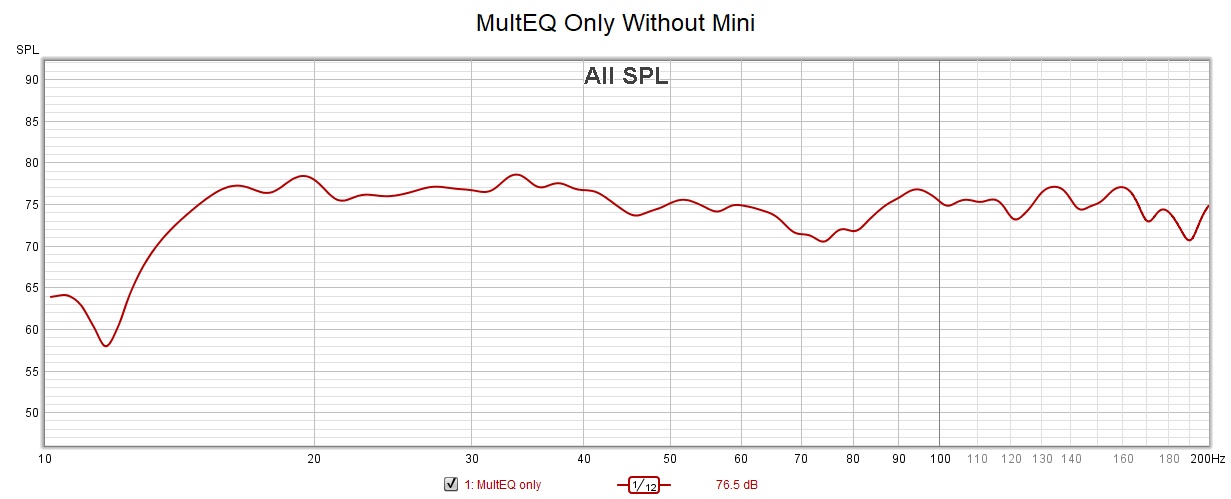

This is what I managed over the weekend. This first chart is right after running room correction.

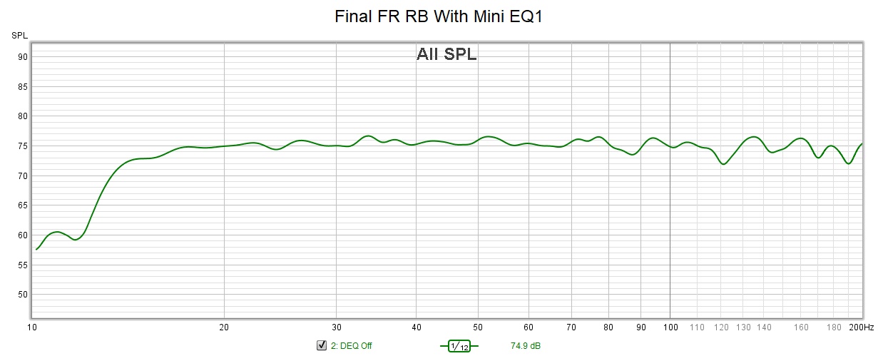

To me that's surprisingly good for only running room correction! I used that sweep and my mini, along with the editor app to end up with this.

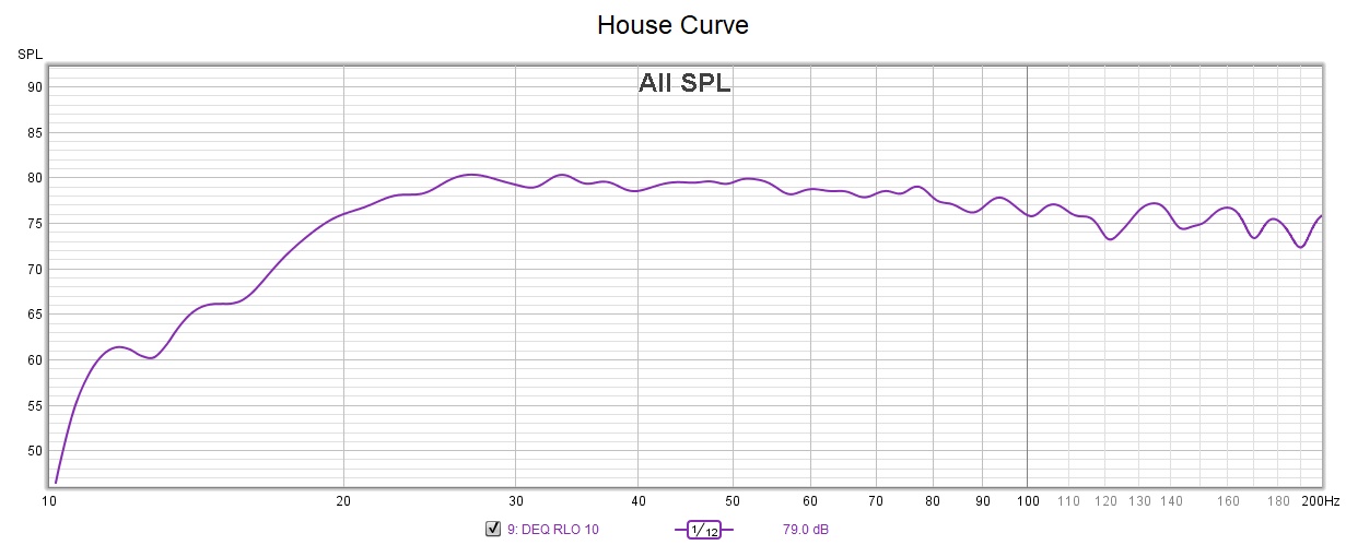

Once I get it nice and flat, I'll remove the port plug from my subs, flip to eq 2 and turn DEQ on with RLO 10.
That's where I have it set mostly for music.

I think you should run Audyssey with your subs in the 2nd chart and see where you're at. You might be surprised. My "before" measurements look WAY worse than yours and look what running Audyssey did in my room!
That's just Audyssey! No tweaking with the app or the mini. I've always said I prefer Audyssey for room correction and this is why. To me that's pretty amazing considering what I started with!
You've already done most of the heavy lifting (literally, lol) finding the best spots for your subs and eq'ing them to where they are now. Now it's Audyssey time!
