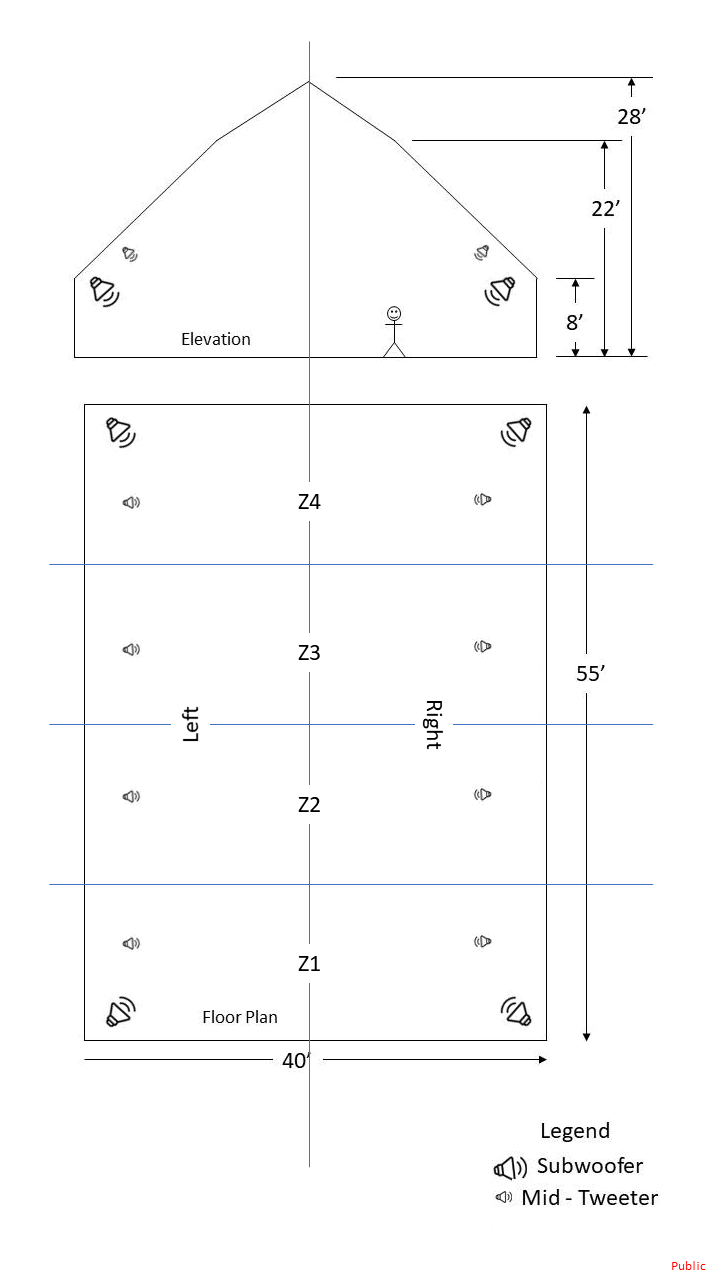

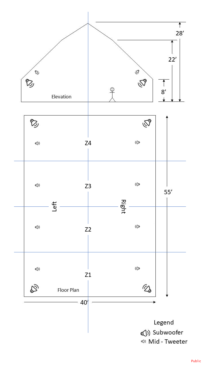

Question on speaker boxes, I can build the speaker boxes into the roof rafters, or I can build independent boxes and mount them to the roof. Do I want any control of speaker orientation? See picture for planned speaker locations.
Right now I plan to use channels 1-8 of the BB1235 in the barn to make 4 zones, with a left and a right for each zone. Channel 9-10 will operate two exterior speakers for the deck. Not sure if I will need to have an independent volume control for the deck, but it is likely.

For subwoofers, you just want to build for the future, or simply hold off for the moment until funds become available then grow into your goals rather than going with a crap solution now which will just waste money. Not sure what speakers you are using for the subs, but good subs aren't really inexpensive and some DSP ahead of them is pretty important as is box design. Seems like you are confident with your box building capabilities, so that should be good, but I am the wrong person to ask about this. I am not a back box builder or speaker builder, so that may be best asked over at Parts Express. There is a lot of building knowledge there.
I think that there is little need for speaker orientation capability after the fact on the finished product. This isn't home theater and you are looking for room filling audio, not pristine perfection as some theater enthusiasts are after. You should be good with fixed location boxes. If it is easy enough to add some adjustments to the speakers, then by all means, please do so.
Be aware that you can add volume controls to your outdoor speakers easily enough. On the amp itself, you have individual channel control if you want to make adjustments.
I would probably get a volume control for outside adjustment. I think I might make adjustments to the amp for interior volume control for the short term. I might add zoned volume controls later on for the main space.
