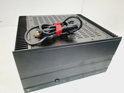

The two on this list I really like are the Sonance 1250. That amp weighs about 80 pounds. It's crazy good. I'm not sure if the condition of the amp encourages me, but it may be perfect for your setup. Also, the SpeakerCraft model is very good and SpeakerCraft has a long reputation of quality products. They were used a ton in installs over the years, and there is a lot of their stuff on eBay at a great price. These amps were all well over $1,000 when new.
Examples...

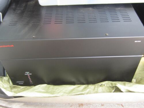

If you could swing a bit more, the higher power amps cost a bit more, but may be worth it. NOTE! The SpeakerCraft 1235 models allow for you to bridge channels. So, a 12 channel amp with 35 watts per channel, becomes a 6 channel amp with 60 or 70 watts per channel. Adding a second amp with 12 total speakers effectively doubles the amount of power to those speakers. Also, if you want to have more speakers, they are stable with 4 ohm loads, capable of driving up to 24 speakers per amplifier!
More than $400 shipped to your door, but under $600 with 50+ watts per channel and in good condition (yes, I am scouring eBay for you here)...
