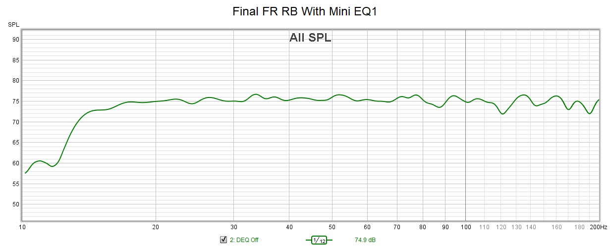

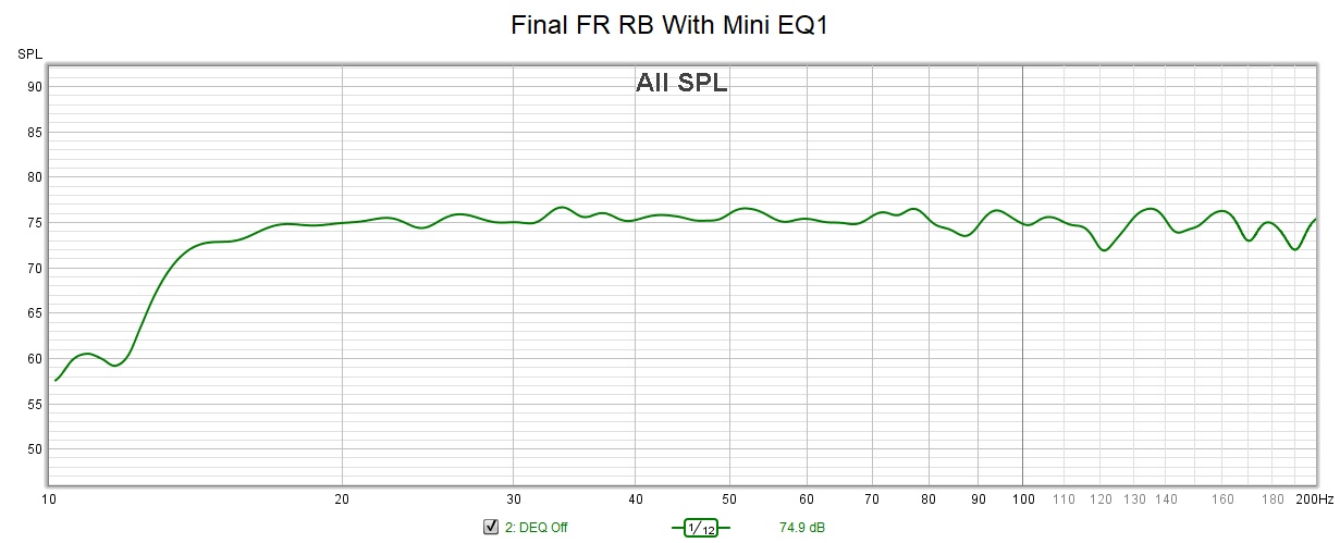

I can accept whatever, but I'm also a realist and have a lot of experience with subs. Both sealed and ported. I'm now curious to see your sweeps since you mention it. Here's one of mine with my dual ported subs.
I'm pretty happy with that. I can dial in a flat response with sealed too, but would need 4 of them to get the same output as my ported VTF-3 MK5s. Other than that, a flat fr is a flat fr, whether using ported or sealed... Were you mixing ported with sealed? What does your chart look like?

Holly crap that’s flat man! Nice work.

Thank you, I definitely put the effort in and did a lot of homework. Still lots to learn tho. That's why I like these forums. There's a lot of collective knowledge and experience here and I seem to learn something new every day still.
