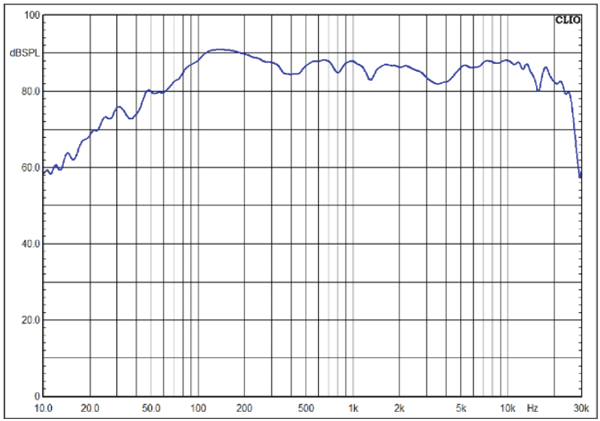

This is the driver.
It is actually a 5 3/4" driver. It has a very robust motor system and suspension with an xmax of 8mm. That is a lot.
You can mount it without a back box, but a 0.25 back box with damping is recommended. It makes for a neat installation.
This is the FR
They are available here.
That is by far the best solution you could think of for a ceiling Atmos speaker. Anyone considering installing Atmos speaker needs to ask themselves why they are not using this driver. It is head and shoulders above all the costly and highly advertised solutions. You need to look no further. If I have not blown mine up and can assure you, that you won't either.
