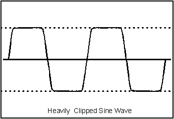

I said it introduces a DC component .. NOT DC!! the squared off top of the signal is much longer in duration than the high frequencies the tweeter it normal receives and its the squared signal component that damages the tweeter. That is due to clipping. An under powered amp can easily destroy a tweeter when the signal is clipped. And if you are so sure that underpowered amps don't clip, I suggest buying a used AVR, hooking your speakers up to it,crank the volume to its max with a CD playing and see how long the tweeters last or feed your tweeters square waves and see how long they last.

Once the signal clips, it introduces a DC component that is far longer in period than the HF sine waves that are being applied to it. Its that long period that causes the voice coil to heat up and burn.
As long as the amp clips symmetically as it should, it will still be AC just with lots of harmonics. Theoretically there will always be some DC offset clipping or not but the magnitude should be so low that even cheap amps can pass for having negligible effects. Also don't forget that crossover blocks low frequencies to the tweeter let alone DC.

I don't mean DC in the strict definition... I'm saying that the flat part of the clipped signal is delivering more power longer to the tweeter than what a sinusoidal wave would deliver.. making it appear as DC time wise compared to that of an unclipped signal. That is why clipping is so inherently deadly to tweeters.
From the same article you linked:
...The common misconception is that the distortion creates harmonics, and the additional harmonic content destroys the tweeter. Not really - woofers and midrange drivers can also blow from a distorted amp, and this is unlikely to have anything to do with harmonics...
My take: it is not the "squared signal component" that damages the speaker. It is the excessive average power that damages the speakers.
Perhaps we are just miscommunicating. Perhaps that is exactly what you are saying - that the clipping can produce the excessive power. And the excessive power is what damages the speakers.
We are saying the same thing. Its the flat part of the waveform where the excessive power occurs but its excessive because of time at the amplitude, not amplitude itself..... I disagreed with your point that clipping is only secondary.... Clipping causes the condition to occur.
No argument here, but ADTG is only emphasing the truth about the average power is what does the damage. To recap, I think all 3 of us can agree on:
Yes, I agree that clipping can be a significant factor because it can cause excessive power.
But I also think that excessive power will occur regardless of clipping if a person were to crank the volume all the way up. :D
