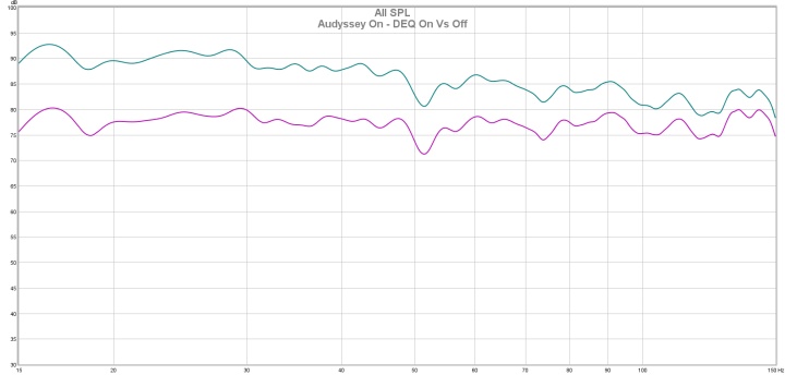

RichB
RichB
Like this, note DEQ compensates less and less as frequency increases.
The volume levels vary between 10 to 20 DB.
Were those taken at the same volume level?
Yes, same volume same everything.
That would certainly explain why folks like it with a baseline increase of 5 DB louder.
It makes it difficult to compare the DEQ On/Off.

It is dynamic so the lower the volume level the higher the boost, relatively speaking. It also boosts the surround effect but I have not tried to measure that yet.

The salient point is, even when you decrease the master volume by 5dB or whatever is comfortable, the sound is still better and fuller with DEQ than without DEQ.
For example, normally my master volume is set to -20.0 when DEQ is off.
When I turn DEQ on, the master volume is then set to -25.0. But now the sound is fuller, bass is punchier, tighter, more musical - it is now more DYNAMIC. But the SPL is the same.
My peak volume is still 94dBC with or without DEQ. With DEQ on, I turn the master volume down to maintain the comfortable volume level.
So it's not like we listen to 90dB without DEQ, and then all of the sudden listen to 100dB with DEQ. We do know how to turn down the volume.
Bottom line, no matter what is on, we do NOT EXCEED the comfortable/ safe volume level.
