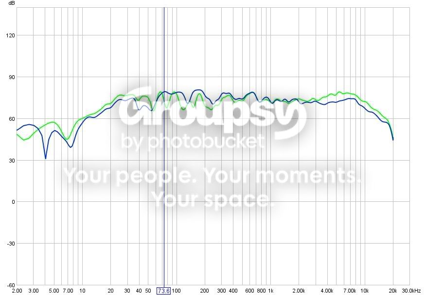

Here is someone's graph of Audyssey MultEQ from Marantz SR7001 (green) vs Emo-Q1 (blue). It seems Emo-Q also does a good job flattening out the FR, probably on par with the 1st generation Audyssey MultEQ.

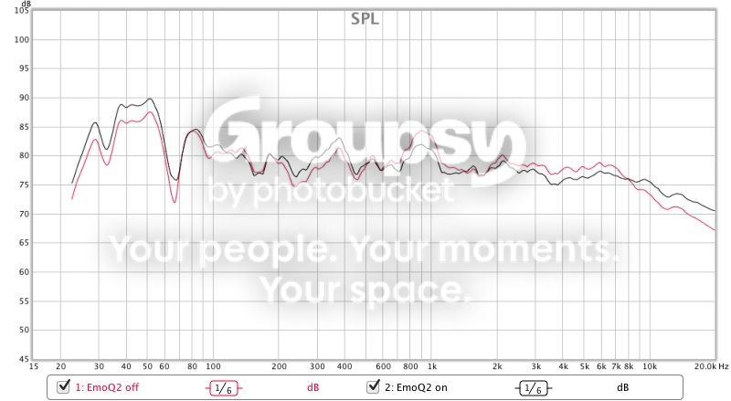

Here is EMO-Q2 (black) vs Pure Direct (red). Does it look like EMO-Q2 did much of anything?
