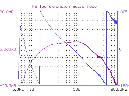

How do they get 20Hz at -3dB out of 2 8" drivers?
Brian Ding is quick to point out that his Servo system is different from all others and they do seem to get a lot of goody out of their components. Maybe it is snake oil, but I'm not willing to believe it and your elvs and unicorns is not a very convincing argument.

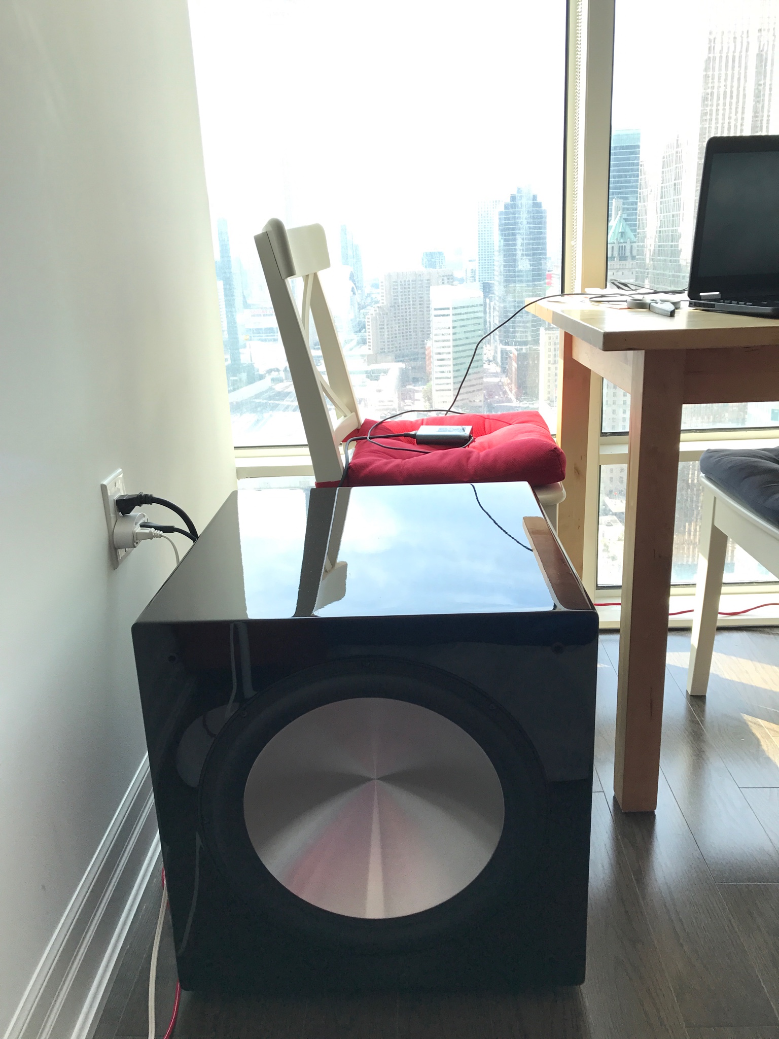

I purchased a B-Stock F15HP-SE with a silver cone and a XLR3 amp for future balanced use.
First impressions, more output than the S1500 in the same spot.
Certain ranges, I think the S1500 does better, but that could be due to distortion raising audibility of those ranges.
Overall, the F15HP seems to be the more refined sub. I'm happy I sent the S1500 back and went for the F15HP. My wallet is not.
I still stand by my previous statement: the best $ value in the 15" sealed front-firing range is the S1500 by PSA, hands down. This wasn't a value purchase for me, rather it was to chase down the most audiophilic sub in a defined range ($1000 - $1500), which is where I place the F15HP.
Plus piano black to match my Sierra-2 wasn't a bad add on to boot.
Roen
Roen
The F15HP-SE is definitely much more heftier to move than the S1500. I would imagine it's close to 50% heavier than the Matte Black Satin S1500. Muscling the Rythmik around was a bit more of a chore than the PSA.
I have more trouble lifting the F15HP-SE without the grill and all other packing materials than I do the S1500 in the box, packed to the brim with all relevant accessories.

Oh wow! Very impressive! Not sure what is better the view you have OR the Rythmik. Love the looks of that driver! I also agree that the S1500 is also an impressive sub. But, for the money I do think the Hsu ULS 15 MK2 is a better price/performance value than the S1500. In the less than $900 range and /or less than $800 range B-stock there is nothing out there that can touch it inmho. If there is, I would certainly like to know about it. Congrats on your new toy! :):):)
