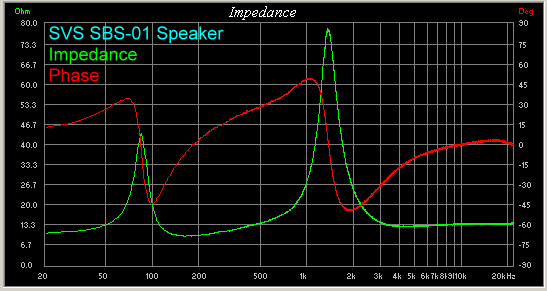

Hometheaterhifi actually provided their graph, you can see that the phase angle plot doesn't look bad either.
Speaker sensitivity: Mains and center - 87 dB (assume 2.83V), surrounds 85 dB.
Based on the graph from the Hometheaterhifi review, those speakers should not be considered hard to drive in small rooms.

No, leave it at the default 8 ohm setting in order to get the unit's rated output. Regardless of what you have previously set it to, if you do a factory reset it will be back to the default 8 ohm setting anyway.
If SVS follows IEC-60268-5, and I believe they do, nominal impedance is no more than 1.25 X the minimum impedance so to quality to be 8 ohm nominal, the minimum impedance will be 6.4 ohm or more.
Yes, that graph is for the SBS-01, but both S&V and Hometheaterhifi indicated that the impedance of the SCS-01, same as SCS-01(M) is similar to or a little higher than that of the SBS-01, so it is safe to assume the same curve for the most part.
I hope I answered your questions.
No, those speakers are legitimately rated at 8 ohm. The impedance curve shows a minimum impedance of about 7 ohm,s with a maximum of 79 ohms. Most of the time the impedance is over 8 ohms. The negative phase angles coincide with the peaks of impedance pretty much. The speakers should be an easy drive.
As I said your receiver easily has enough power to make toast of those speakers.
If there is an issue with the Marantz, then that unit must be faulty. However it would pretty much have to be in the power supply is all the channels seem to be giving trouble.
My money is on speakers. If you have an old speaker around you don't want, take it apart and just look at the voice coil and how closely it is confined. Now just compare it to the power going to an incandescent light bulb and how hot even a 40 watt bulb gets. Then you understand that speakers only get away with it because most of the time we use very little power. If we don't you can see how quickly a voice coil is damaged. A 5" speaker takes very little power to start frying the insulation. Then the power output drops and the impedance drops which can damage amps
