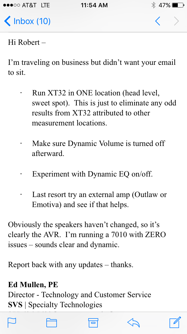

Hey guys I just got this: turns out I did find running Audyssey in one location and using the minimum mic placemenents allowable yielded the best sound, all others have been attempted with the exception of the outboard amp option, which I don't have the time to try and get in my house. I'm pretty much done with the Marantz. My mission has become clear. :)
You have a defective Marantz but you could save $200 by getting it replaced by another SR6011 and see for yourself.. I am sure that it's the one you bought which is defective. Marantz is usually a very reliable product.
