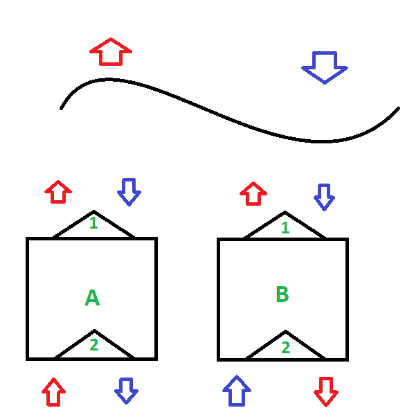

Since I am of a simple mind, and not too good with graphics I put the drawing below together. In the drawing there is a sine wave and two "enclosures," A & B. The triangles 1 & 2 are two drivers in each enclosure. The red & blue arrows signify which way the cone of the drivers move when the portion of the sine wave excites them.
Does the Perlisten subwoofer work like example A or B?
I don’t really follow those images.
in the Perlisten Subs, both Drivers excurse outwards, in phase with each other.
if I really try to interpret those images, you need “C:”
Red arrows in phase and both excursing outwards at the same time.
Just one toward the motor, and one away.
So, take “a” and reverse the direction of the arrows for “2” to reflect the actual motion of the Drivers.
B
ryanosaur
ryanosaur
Forgive if I am being daft, but both red arrows should be pointing outward at the same time, and both blue arrows should be pointing inward at the same time, correct? That is the physical action and represents both Drivers excusing together in-phase.
