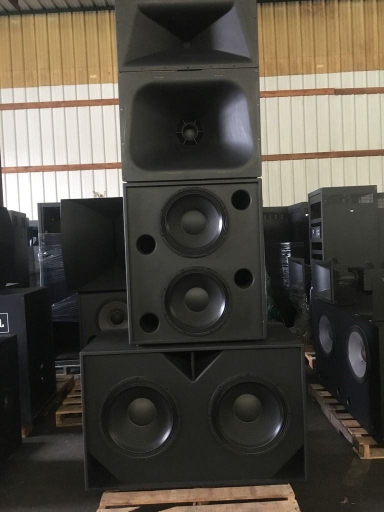

here's my bass cabinets and two horns that I can't fit right now the picture doesn't do these justice they are massive in size I'm 5'8 and reach the top of the second cabinet, bottom cabinet is 2 18's :)

Wife Acceptance Factor. My wife lets me get away with a lot in our living room, but I keep things clean, neat and tidy. What I don't have is a mancave. That's pretty awesome. I'd love that.
Make no mistake if this was in my living room i'd be a dead man LOL
