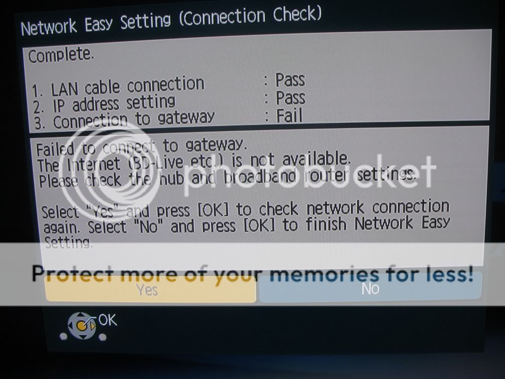

    Im trying to connect my bluray player to the internet. It passes the 1st two test but fails the Gateway connection test. It says to check my router or hub. I have it connected to a Belkin wireless N router. Do I need to change something on the router? I thought all I would have to do is plug in the network cable and it would work. Thanks for any help you can give.

    I have not changed anything manualy. All I have done is run a cat5 cable from my router to my bluray player. Then I go to the network setup in the player and select "wired" connection. The it does a "Networ Easy Setting (Connection Check)". I pass the LAN cable connection and the IP address setting but fail the Connection to gateway. It says, "Please check the jub and broadband router settings". Im not sure what I need to check. I also ran a cat5 cable for my Dish reciver and it has no problem connecting. I even tried swaping the cables and the bluray player still cannot connect. I have rebooted the modem and router several times but that has not worked either. I have read the manual but all it says is to connect a network cable and run the setup. Is there a setting that I need to change on my router? Is it the player?

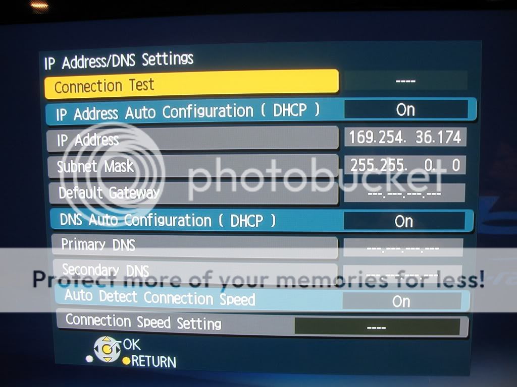

    Did you enable MAC address filtering or limit the number of connections allowed? If so, add the MAC address of the player to the router and/or make sure the number of connected devices allowed is greater than the total number of devices connected to the router.
    Log into the router and check the value of the IP address that was assigned and the default gateway.

    If you're talking about the WEP or WPA passphrase for wireless it isn't necessary for wired connections. That passphrase is used to create a key to encrypt the wireless data.
    From your description it sounds like there is a problem with the player seeing the gateway (which will be the router). If the gateway address the player is using doesn't match there will be no way to get packets not destined for the local network out to the internet.
    That's why I suggested looking at the network config: ip address, netmask, default gateway address. Does the player offer a menu option to display those values?

    Well I was thinking if you can find the information and post it and the stats for other devices connected to the same router I could see if there is anything obviously wrong and try to help.

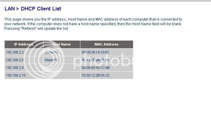

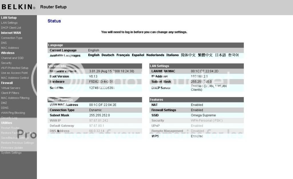

    Reset the router and started from scratch and I still can't connect the bluray or sat receiver. Im not sure why the sat receiver is not connecting anymore. Anyway, I tried these steps on this website and it did not work either. http://www.fixya.com/support/t7035724-im_having_trouble_connecting Here are my settings of my router and bluray player. One of the pics shows everything connected to the network. Im guessing the ones labeled with numbers and letter are the bluray and sat receiver. Thanks again for any help.
