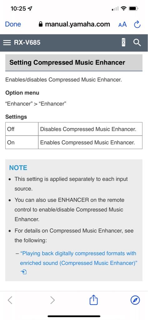

I haven't used it for multi channel input so cannot tell if there is any difference. I could try though. The manual advertises this feature as very useful for stereo input:
