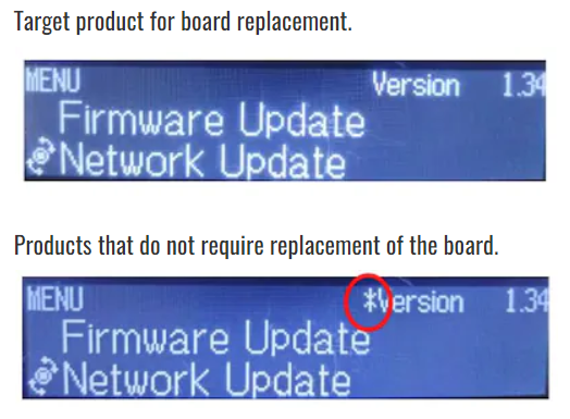

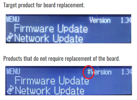

Hey guys, a bit late on this but, how can I confirm if my RX-V6A needs the board replacement or not? On this Yamaha news page it says to check if there is an * before the version on the firmware menu of the unit:
Update for HDMI Compatibility of Select 2020 AV Receivers with Certain Gaming, Video Devices (...png
Mine does no have the *, but I have registered my unit on the Yamaha website on November 2021 and haven't received any email about the replacement. Do I have to register elsewhere?
I haven't worried about this because I don't currently have the need for 4k/120Hz, but I might in the near future.
Did you sign up here?
Filipe
Filipe
Isn't that just the normal registration? I'm in Europe, I registered on the European site. If I try to use my login on the US version it doesn't work.
The European version of that news page says "we will inform registered and affected customers in the order of the registration date step by step. Be sure to register your product to get direct communication about the update program. click here."
Clicking on the "click here" opens the product registration page, where I already have my receiver registered. If they informed the customers in the order of the registration I should have been contacted already seeing that I registered before they even started the program..

Yes, it does seem as though you should have been contacted by now. Have you reached out to them?
Filipe
Filipe
Yes, the answer is that I have to wait to be contacted by Yamaha..
To the people here that already have been contacted, on what date did you make your product registration?
Trebdp83
I registered my RX-V6A back in early November. My unit needed the replacement. I received confirmation of registration and enrollment in the replacement program within a couple of hours. But, I’d been in close contact with Yamaha concerning the RX-V6A for some time. While United Radio Consumer Electronics handled the HDMI board replacements in the US, I have no information about the handling in Europe.
