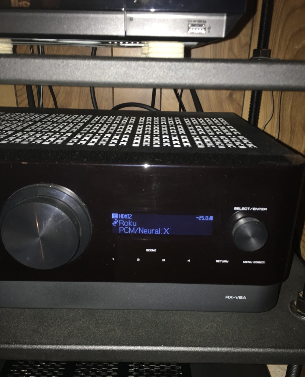

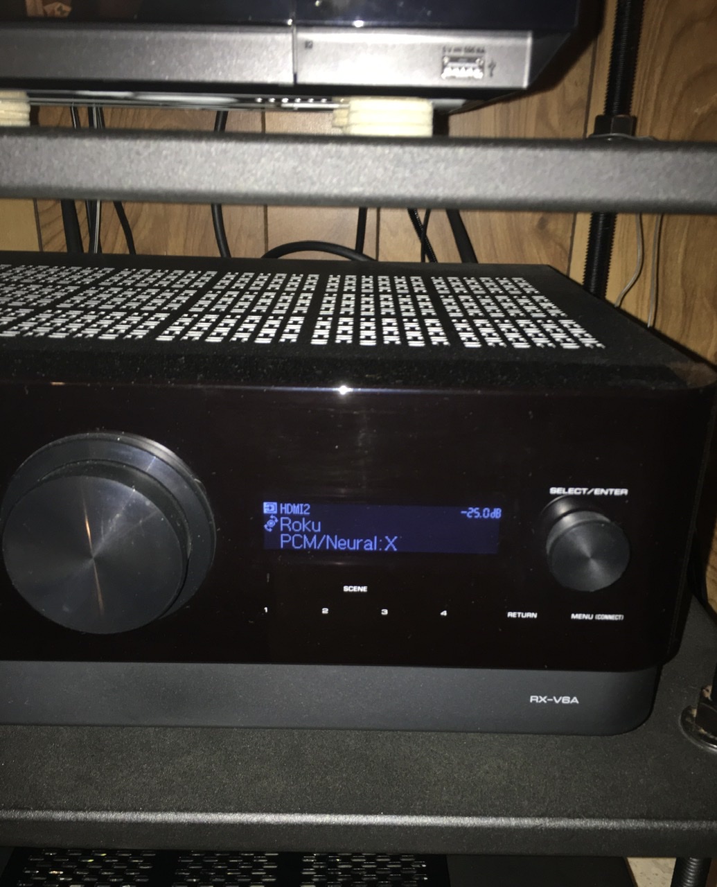

I had that issues, I had my Roku set to "Auto" for sound output in settings, My V6a wouldn't show Atmos or DTS-X. I went back into settings on my Roku and set it to stereo and now my AVR shows Atoms and or DTS-X. I should note that the Roku I have isn't a 4K, But My V6a does up convert sooo. ;)

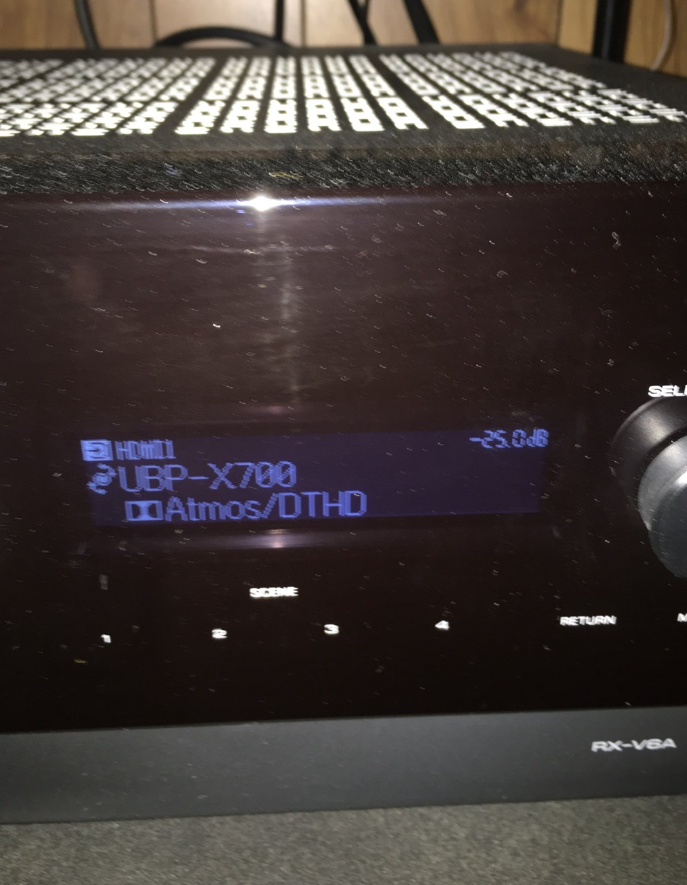

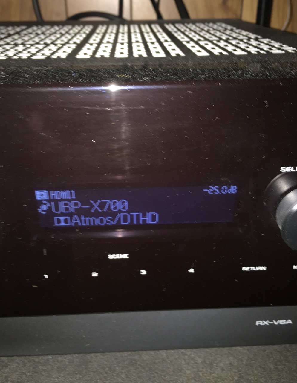

View attachment 45787View attachment 45788
