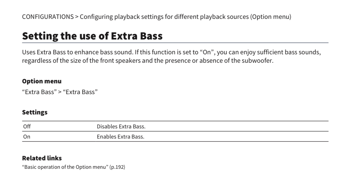

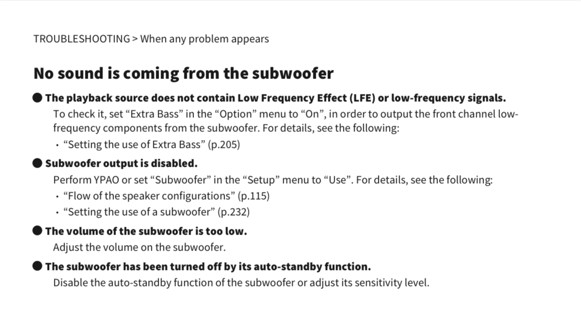

Subwoofer dies out as soon as I switch the fronts to large. Double bass, does that mean set SW2 to "use" as well?
C
Christianms
Yeah try that.
Thanks! I'll try that, and the "extra bass" feature later today.
I've run them as small up until the review of my speakers. Figured I'd try it since it was recommended. But now I also want to figure out if my AV is malfunctioning, or if it's unable to run this setup.
Tankini
Also in (Stereo) mode,2.0 the there will be No Signal sent from the AVR to your Sub/S, when front L/R are set to Larger. you'll have to click on (Extra Bass) in order to get 2.1 or 2.2. When L/R main speakers are set to Large, I believe the signal is fixed at 120 Hz. But only when in Stereo mode, two channel. When Extra Bass is set to (On) you will get 2.1 for Stereo mode. Most set front L/R to small and use the cutoff settings at 80Hz as a starting point. As for Sub 2? Either or, both are Mono. Want more than 2 subs? Just daisy chain your Subs. There's this one dude he has 10 Subs in his set-up.
Trebdp83
The Yamaha Extra Bass feature sends the low frequency signals, not to be confused with the LFE, of the Front channels to the subwoofer regardless of the Front speakers size setting.
While the setting works with Large Front speakers as it should, NEVER use it with Small Front speakers. It will actually boost bass sounds and things can get ugly.
I’d set the Front to Small and leave Extra Bass OFF. While it works with Front set to Large, you cannot do anything about the low frequencies copied to the subwoofer as they are fixed.
There may be no issues with 2.0 signals, but multichannel signals can pack a wallop and the Fronts will be hit with Full Band signals. It can muddy things up or harm Front speakers if pushed too hard when set to Large.
Small Front speaker setting will allow for more tweaking and better integration of speakers and subs and lighten the load on the receiver. Heat here is not your friend. Let the subs do what they do best.
