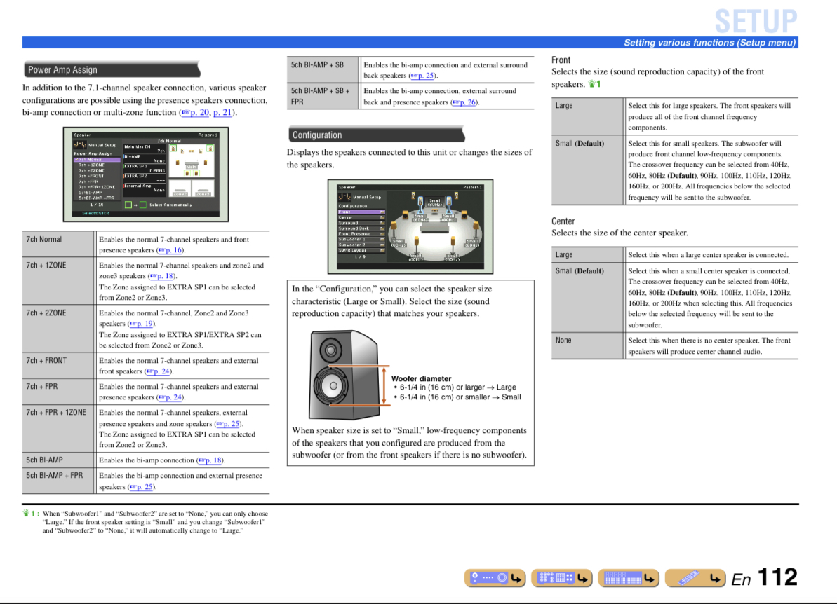

This is my first post and I am in need of some advice. My system has not been fiddled with and all was sounding beautiful when I just lost all of my bass. I am using my AV receiver as a pre-amp and 5CH Emotiva power amp. A fever things to mention going through the set up the RX-A2000 I have not made any changes till this point of no bass output. I had the Front L+R set up as Large. Centre + Surround F+R as Small @ 80Hhz.
Surr Back, Front Prescence, Sub 1 and Sub 2 all set to None.
Power Amp Assig as 7 Channel Normal
I now notice that Front speaker option in set up is shaded out and I cannot alter it. Only when I set SUB Woofer 1 or 2 as active does the Front Spkr option show up and will allow me to click on it. It does say Large. This is what it needs to be at as my Tritons each have a 1200W DSP Controlled Digital Amp. Both speakers power up and the Green LED is on solid. I had one of my Triton amps previously replaced. The green LED flashed on and off constantly showing a speaker fault. All Speaker/ comp interconnects are by Emotiva. Is my Yamaha RX-A2000 at fault. I know that it should show Front Spkr in the set up without having to have the sub woofer active to show. Any thoughts on how I can sort this out.

I don't really have much other settings to try. It's Small or Large. Large setting will allow the Tritons subs to handle the low frequency. Presently it is as if there is no bass speakers present.
Trebdp83
Sorry, so misread that one and thought you had separate subs. The Large setting would be correct. You might try setting to Small and connecting from the Sub Outs to the LFE in on the speakers to see what happens. If nothing, well…
