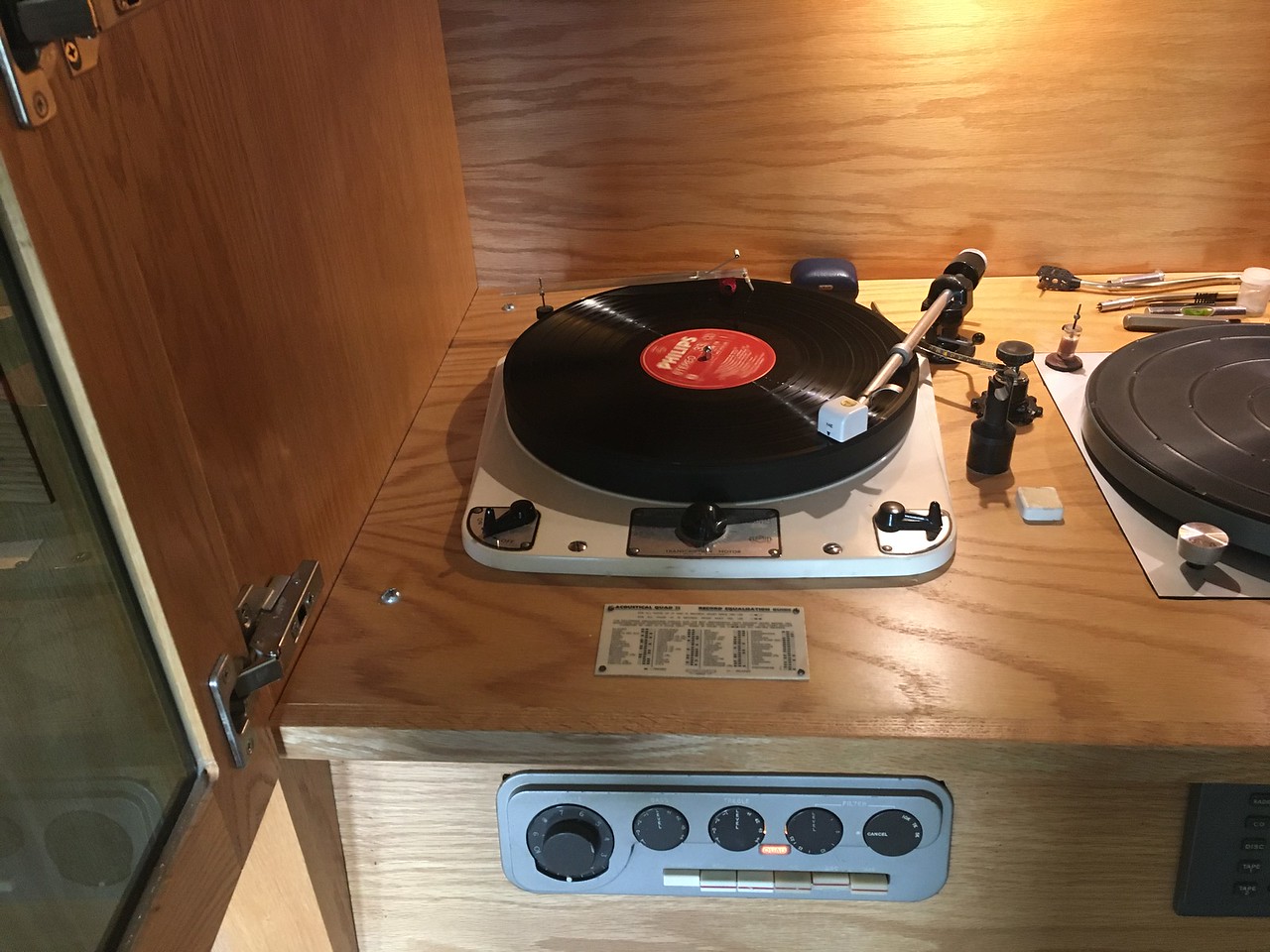

Angling the cartridge in a straight arm is just fine. That Yamaha turntable has a straight arm and NON angled cartridge, which is just plain wrong.
You can download a turntable protractor here.
If you had tested that Yamaha turntable you would have demonstrated massive tracking errors.
You do not have to have a S-shaped arm, then the cartridge has to be angled correctly.
Here is a straight arm with and angled cartridge. Decca ffss H4E on a Decca professional arm.
Here is an S-shaped arm.
This is an SME series 3 arm with silicone damper, with Shure V15 xmr. SME designed this arm to optimize the sure V15 xmr. It will of course accommodate a wide variety of cartridges.
The earlier SME arms were designed preferentially for high compliance MM cartridges. In order to get the cartridge arm resonance in the optimal range this requires lower mass arm designs. As MC cartridges became more popular, SME introduced higher mass arms.
I personally favor MM cartridges. Whilst MC cartridges can sound superb on certain records, their lower compliance is against them in higher modulated difficult to track LPs. This especially tends to occur in final crescendo on the inside groove. I do own a couple of MC cartridges, but I don't use them. In my view an SME series III arm with a Shure V15 xmr with the silicone damper in use, is the apex of disc reproduction. The Shure is unfortunately NLA, but I suspect the Ortofon Black is a really good alternative.
That Yamaha turntable is just incorrectly engineered and will have high distortion and excess stylus ware, if the cartridge is elliptical, and also cause excess record ware. So that Yamaha turntable needs to be avoided.

Disc enthusiasts know this as can be seen from the premium prices good older turntables and SME series II and especially the series III arms command.
Many chromium plated exotic modern turntables can look impressive and really contribute nothing significant except high cost and often erroneous engineering.
A turntable like this will give the best performance possible from LP reproduction, going further is just gratuitous complication.
A good turntable system properly set up is capable of very high quality reproduction, and with a well cared for disc, is very hard to distinguish from the best digital sources. Unless you use dbx encoded LPs, the dynamic range has to be compressed slightly, but is still very impressive. A properly set up high quality turntable with a good cartridge damped and with the arm/cartridge resonance optimized will not make your woofers flap or be prone to acoustic feedback. That is not an issue with any of my four turntables.
Digital sources are much more user friendly and much more plug and play. Optimizing vinyl disc reproduction takes the correct match of the components, technical expertise and experience to optimize it. In addition great care in handling and storing the discs is required.
I am puzzled by the return of vinyl LP sales and playback equipment. I can only assume it is the ritual and return of human interaction. I think this applies to some extent to magnetic tape reproduction. However in that medium the challenges are amplified and there is no ready availability of playback material. However, I would never have predicted the return of the vinyl disc on the scale that this seems to have occurred. So I think to optimize it, then devotees who need to look back to the sixties, seventies and early eighties for the wisdom of that time.
That Yamaha turntable shows that my advice needs to be headed. That unit will fall far short of the quality obtainable from vinyl.
It is small wonder that the equipment that I have used and cared for over the greater part of my life appreciates faster than my retirement accounts.
