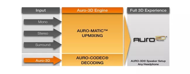

The document you shared the link to does mention, quote: 'standard 5.1 PCM stream'. This would be meaningless too, if the word 'stream' is synonym with the word 'carrier'. Naming does not seem accidental, but it may sound confusing, I agree.
To simplify the gobbledygook, Auro 3D relies on original PCM mix for backwards compatibility with devices without Auro codec decoder. Original input could be mono, stereo, surround or Auro-3D file. Auro 3D engine would then use either decoder or upmixer to present original audio in Auro 3D speaker configuration.
Upmixing, LOL. There is no embedded spatial, esp. height, info to be extracted from these mono, stereo or surround signals to be meaningfully reproduced in a multi-speaker setup. This is simply filtering and delaying some sounds to create a reverb simulating "spaciousness" which marketing misrepresents as "full 3D experience."
