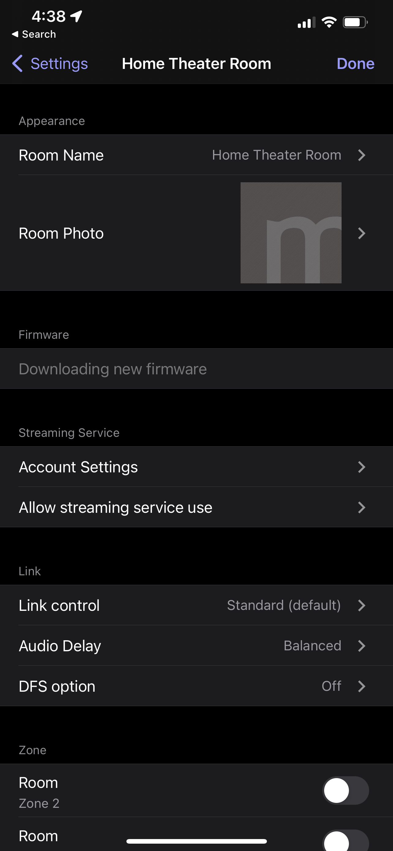

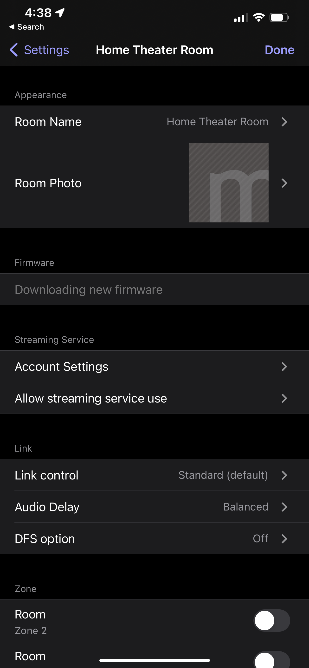

The firmware update took maybe three minutes. But what a mess. When I press on display information I simply lose the sound and it’s then the tv that plays the sound. On the edge to return my Yamaha if they are releasing such updates. It’s not like they didn’t taken their time. My amp s basically not working
OldAndSlowDev
OldAndSlowDev
My music plays for 5s on the amp, and then stop and plays on the tv instead of the amp and speakers. Wtf Yamaha.
