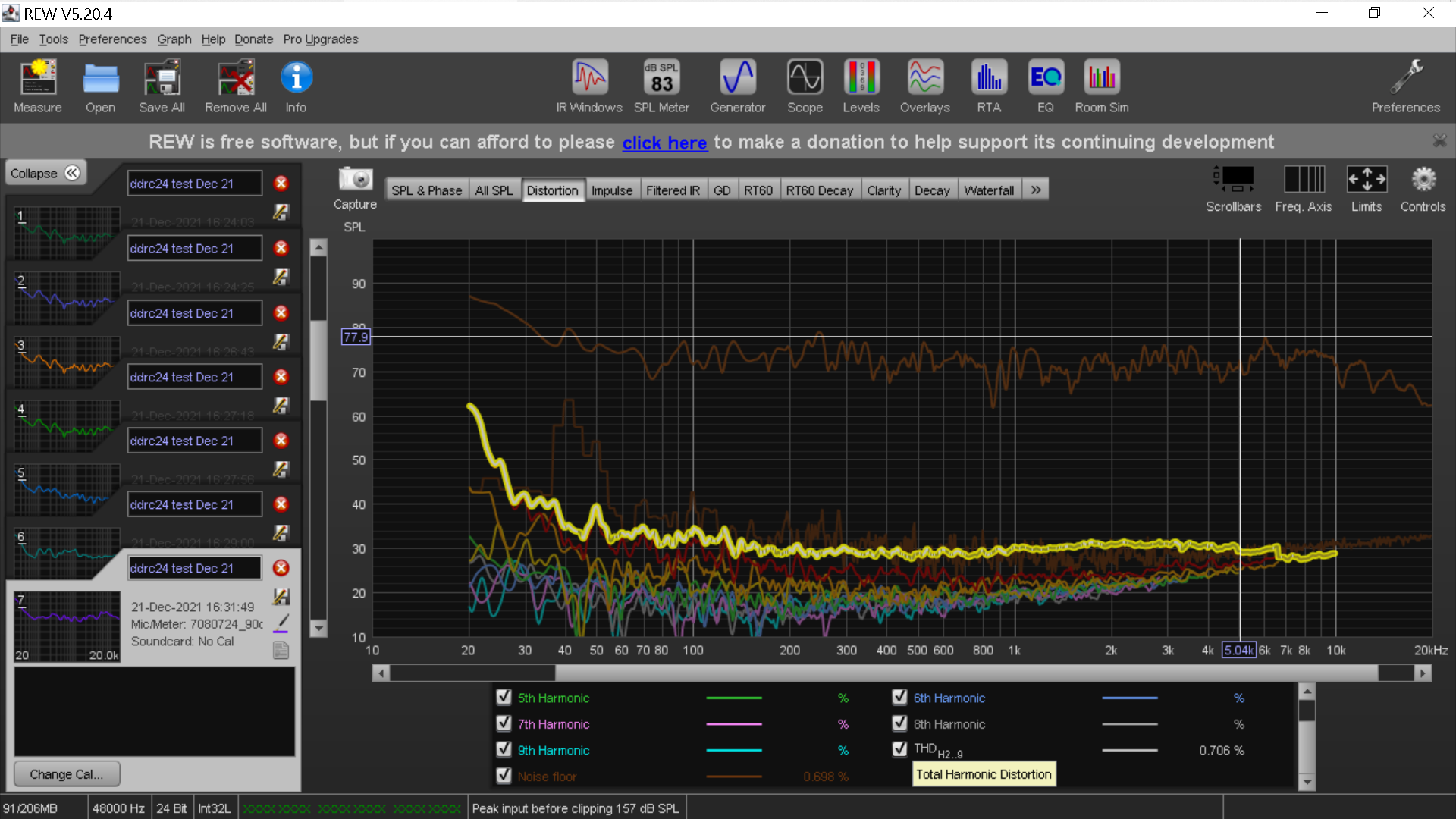

Yesterday I started to test attaching a MiniDSP DDRC-24 to the mains pre-out to test what Dirac does in my room. I was following some instructions which included running REW through the MiniDSP using the Java setting. Response looked weird. To confirm that all was okay I redid it with my normal ASIO4ALL settings, which was normal.
Though this was the channel with the best THD -
0.706% THD. o_O though all at, or below, noise floor. So the odd .05% extra ain't gonna bother me much.

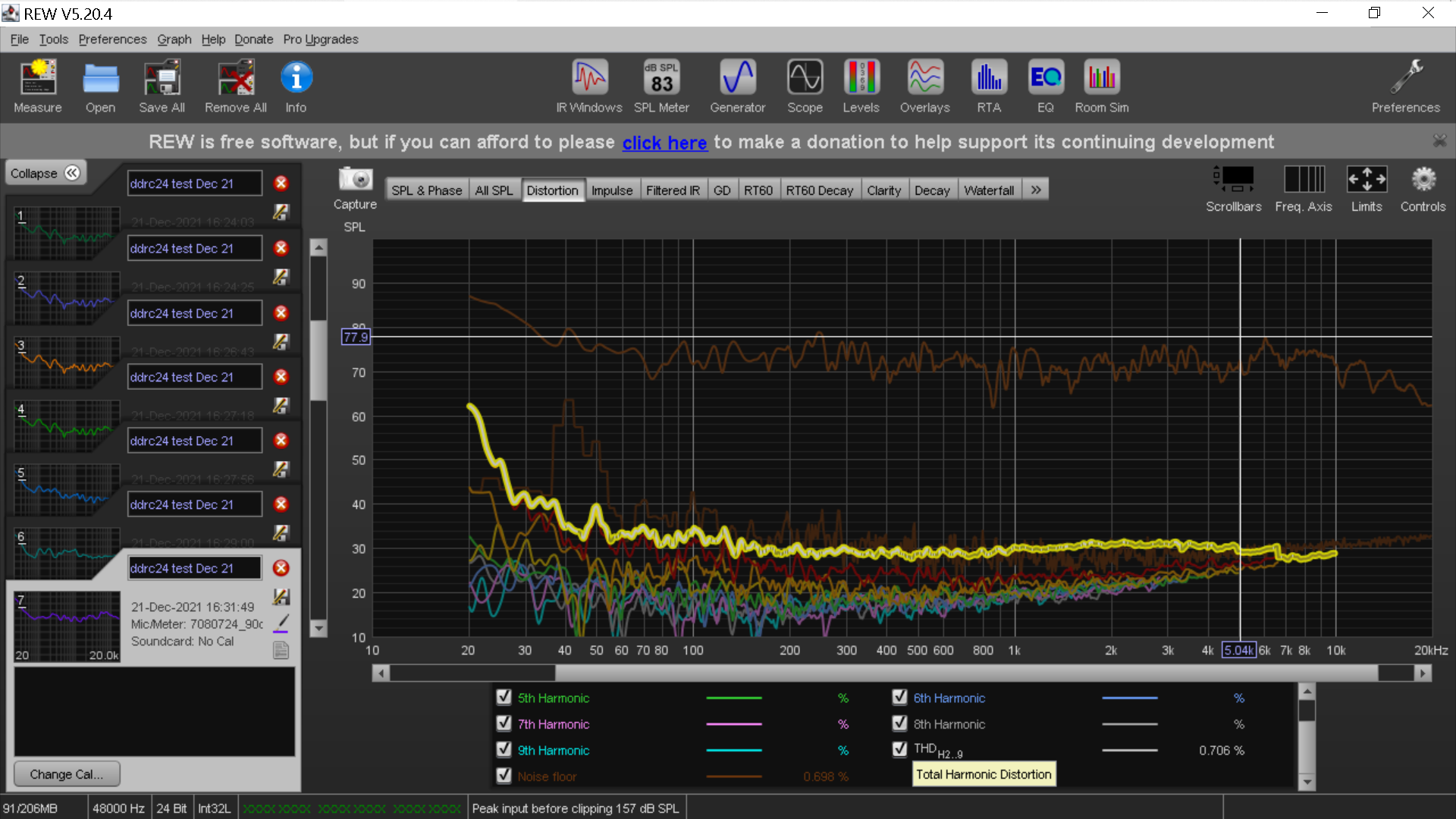

I ran the ASIO4ALL tests in Straight mode as I wanted to include the sub in the measurements. So the signal will have been through DSP. (I had removed the MiniDSP) If I did the tests again in pure direct the result would be almost identical above 80Hz.
The speakers and the sound bouncing around in the room add nearly all the distortion. :)

The UMIK-1 mike was slightly more than 10 feet from the mains when I ran the tests. Average THD of the mains and centre just under 1%.
