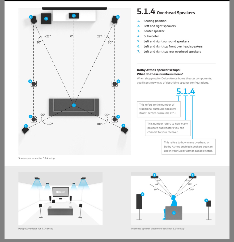

How do you setup the 5.1.4? Just curious.... I mean where are the placement of the speakers? What I mentioned before is good for 5.1.2 though right?
snakeeyes
With 4 height speakers there is a pair in front and behind the listening position. I was looking at RSL 34e that mount in the ceiling for my room but I haven’t decided for sure yet.
William Lemmerhirt
William Lemmerhirt

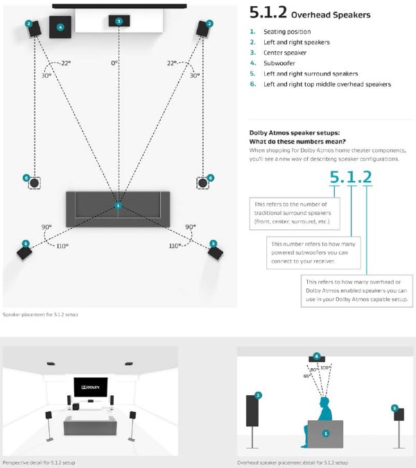

Something else I’ve seen consistently is basically make sure the atmos speakers (in x.x.4 anyways) are situated so when you draw a line diagonally from each corner the LP is centered. Another thing I’ve seen stated a lot is it’s harder to get atmos wrong than it is to get it right.
C
cameron paterson
I looked at the pictures and why are the atmos speakers pointed straight forward and not pointed directly 3 feet ahead of LP. I thought I would do 3 feet ahead pointed straight sideways 3 feet ahead of the LP.
William Lemmerhirt
William Lemmerhirt
Which ones exactly? I think the pics are just for reference. Normally the Atmos speakers would be pointed straight down at the floor(if they have wide dispersion) or at the LP
panteragstk
panteragstk
Agreed. I'm curious as to what he means by "straight sideways"
