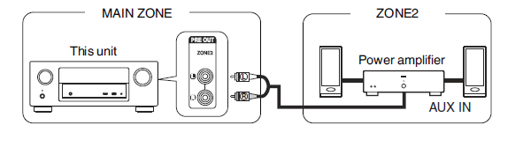

Multi-Source/Multi-room
With the AVR-X1300W it's possible to enjoy 5.1-channel surround in one room, while another 'zone' plays another source–such as CD or streaming audio. You can simply connect a pair of stereo speakers to the multi-room amplified outputs. Or, connect a separate stereo amp and speakers to the Zone 2 pre-outs, allowing full 7 channel surround sound in the main room with stereo in the second.
Page 142 of my manual
Connection 2 : Connection using an external
amplifier (ZONE2)
The audio signals of this unit’s ZONE2 audio output connectors are
output to the ZONE2 amplifiers and played on these amplifiers.
Regarding post 17
That's exactly what I did.
I made the same mistake when I "upgraded" my receiver. You have to look for a full set of preouts (not just zone 2) to use an amplifier the way you want to. Those are generally offered only in the mid to upper tier receivers. With Denon that starts with their 3000 series and up models.

So to be clear, the Pre Out (Zone 2) L/R on the AVR-X1300W cannot be used for external amplification?
Technically speaking, you can use it but it is not a practical solution unless you use them as intended, e.g., for zone 2.
