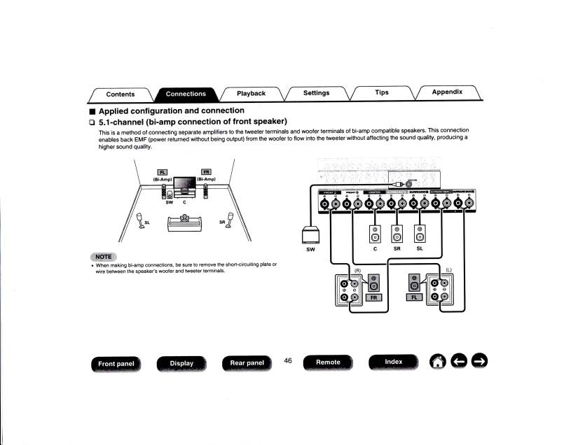

That is called passive biamping, you still use the speakers passive crossover. Only a hand full of speakers are designed for passive biamping ( and they are designed with jumpers that reconfigure the crossover) that are available.
What you mention is inexact. I did actively bi-amp my front left and right speakers with the Marantz SR5010 with its inboard electronic crossovers as indicated on Page 46 of the Owner's Manual. (See attached page in post #17)
I did not need to use a passive crossover for the Dayton subs used in my DIY front speakers. I know damn well what is active bi-amping and what is passive.
R
roadwarrior
No, it's not.
You've added the word "active" here not Denon's literature. Except for that junk about back EMF making the tweeters shine there's no mention whatsoever about active anything. Wonder why that is? Here's the pic again so you can actually read what it states and what it doesn't.
And here's the 2016 Denon's owners thread faqs section sticky on Denon/Marantz bi-amp on AVS:
"known as "passive bi-amping") generally produces no noticeable improvement in either audio quality nor extra power as you're simply sending the same full range signal to each set of posts on the bi-ampable speaker (which they would still get with a single connection) from the same single power supply in the AVR."

That is the page from the Owner's Manual for my Marantz SR5010.
If I'm mistaken, could you explain to me why Marantz would talk about a passive bi-amping? I don't think so.

When you use 2 amplifiers with no passive crossover in between, in order to divide the frequency range, you definitely require electronic crossovers. I know for a fact, because I used the feature for a certain period, and there was no mid or high frequency signal coming out of the subs, and no signal below 200 Hz going to the mid-woofers.
Then, if that was not active bi-amping????o_O
If I'm mistaken, then could you explain why Marantz would allow a feature for passive bi-amping with 2 amplifiers for each speaker ? That seems really ackward!
Passive biamping with the use of 2 amplifiers on same speaker is an audiophool idea!

I've just verified on the active crossover question. Marantz did confirm to someone on the AVS forum that the biamping feature in their SR Series receivers is indeed active. :D
R
roadwarrior
Great! Then have that outsourced customer service rep get the engineers/marketing team at D&M to change their own owners manuals to reflect that(kind of important) fact then. You want to know why they won't? Because it's not true.
The SR series Marantz's are just the Denon X2*00/X3*00/X4*00 models with HDAM , multi channel analog and phono inputs and none of this drivel has ever been "confirmed" in any of those owners threads with the exact same receivers.
While your at it get the AVS Marantz owners thread to revamp their own sticky as well:
"(17) Circuit diagram on how passive bi-amping and bi-wiring is accomplished is shown in post number 4,621. Chuck Hawks explains in simple English the issue of passive bi-amping/bi-wiring in the following article here:http://www.chuckhawks.com/bi-wire_bi-amp.htm"
