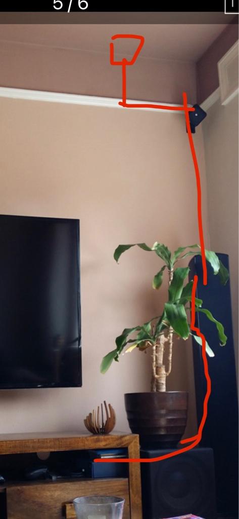

But! IMO you’d be served well to replace the Boston’s with the domes and move them in a little bit and up a little bit. Like this…
Or better yet on the ceiling at about 75-80°
IMO you’d get better in room object imaging and overall performance. I can’t tell from the pic but they seem to be outside recommended angles. Also, fwiw, there are ways to make cables harder to see and while I’d really push for a pair of rear heights, I understand WAF can be very tricky. Better option is going in ceiling, but that’s a different can of worms.

I'm afraid moving the front heights is not an option, however better the end result would be. :/
As far as ceiling speakers are concerned, it's a can of worms that will never be opened. :D
If I end-up giving up on this experiment the domes might indeed replace the Bostons.
