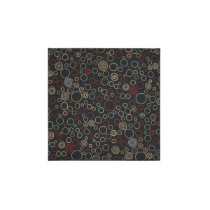

I ended up getting 4 custom panels made from ATS Acoustics, they are not far from where I live....
I went with 2 - 18" x 60" (2" thick) behind my plasma, and 2 of the same to the left of the bay window... in This Color fabric
And I bought a setup like THIS in THIS COLOR on the opposite wall behind the couches...
I looked everywhere to find some attractive looking panels....
I should be getting those soon, and will post pics when I get them all hung..
