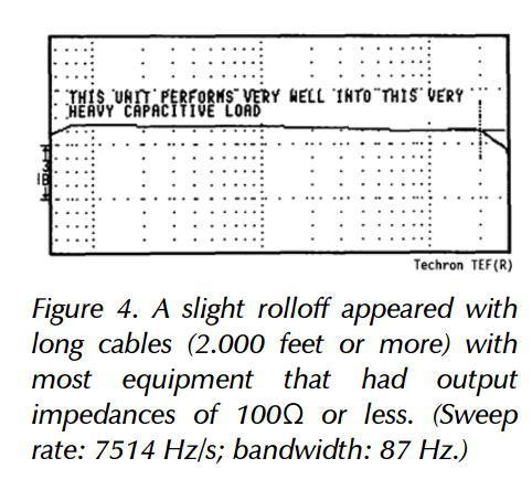

I only skimmed the article, but page 3 seems to be reasonably relevant.
http://audiosystemsgroup.com/CableCapacitance.pdf
As Biz said, it really only affects high frequencies and you'll need a couple hundred foot run before that even begins to happen.
