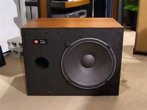

I purchased my sub back in 1986, a passive JBL B-380. I only had a stereo system at that time, although I was using a multi-channel preamp with sub output, which made integration of the sub easy. I originally powered the sub with a Sony TA-N55ES in bridged mode for about 300 watts to the sub. That was not enough power to prevent clipping on some music. Clipping, the sub sounded like a sledge hammer whacking a steel pylon. I thereafter hooked up a Sony TA-N80ES in bridged mode for 560 watts to the sub. That was enough power to prevent clipping to this day. Interestingly enough, the manual for the B-380 suggested 600 watts to it. So, what's the point? Active subs are just easier to get up and running and generally cost less than an equivalent passive sub which will require the purchase of an appropriate amp. The appropriate amp is what's not guaranteed, while the active sub most assuredly
has an amp that's perfectly matched to the speakers power needs.
