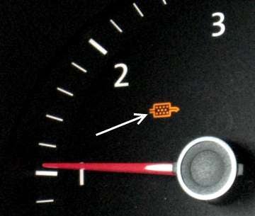

The real problem is the DPF filter.
There is abundant evidence that these small carbon particles are very damaging to health and increase cardiovascular mortality. In addition they are the principal cause of non cigarette related lung cancer.
Studies of cardiovascular mortality have been conducted around the world. Along urban interstates CV mortality is increased seven to 8 fold, and you have to get at least 7 miles from the interstate to get back to baseline.
So removing them is important, the problem is that many of the removal methods can have a devastating effect on engines, especially in very cold temperatures, where regeneration is often incomplete.
