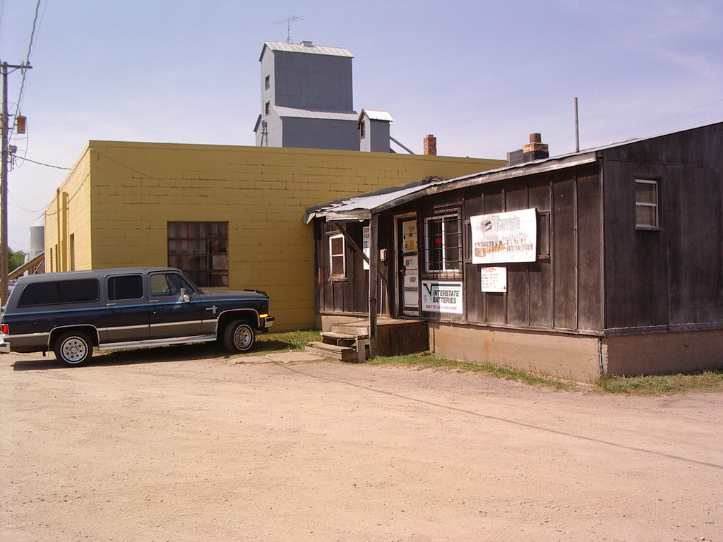

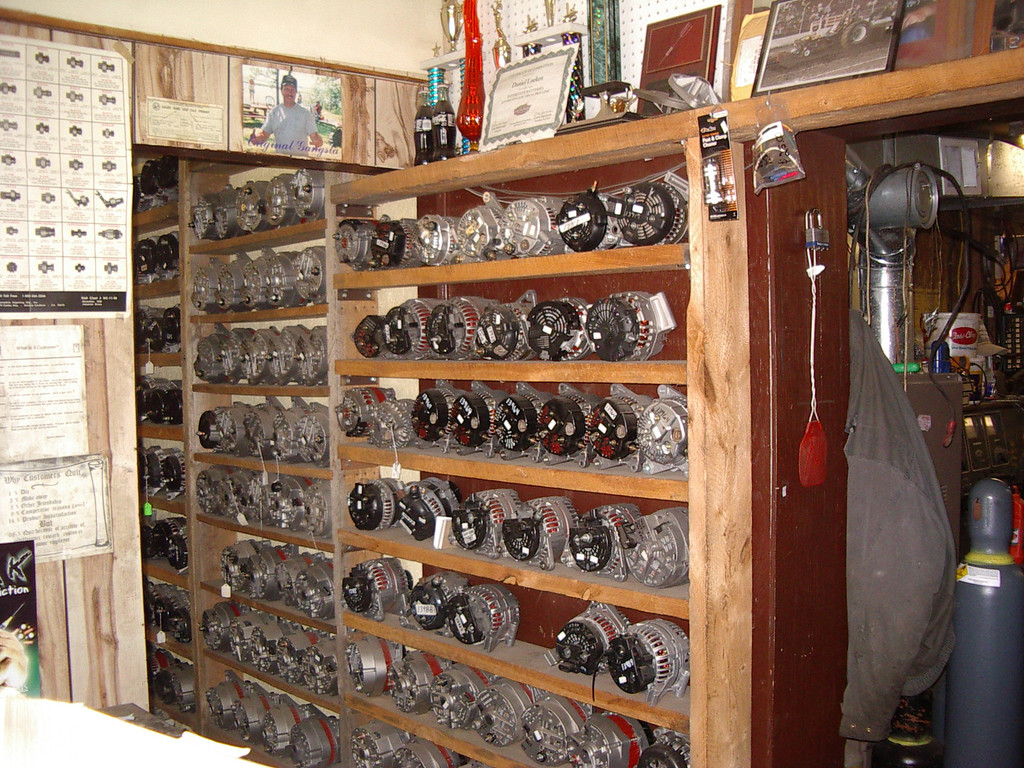

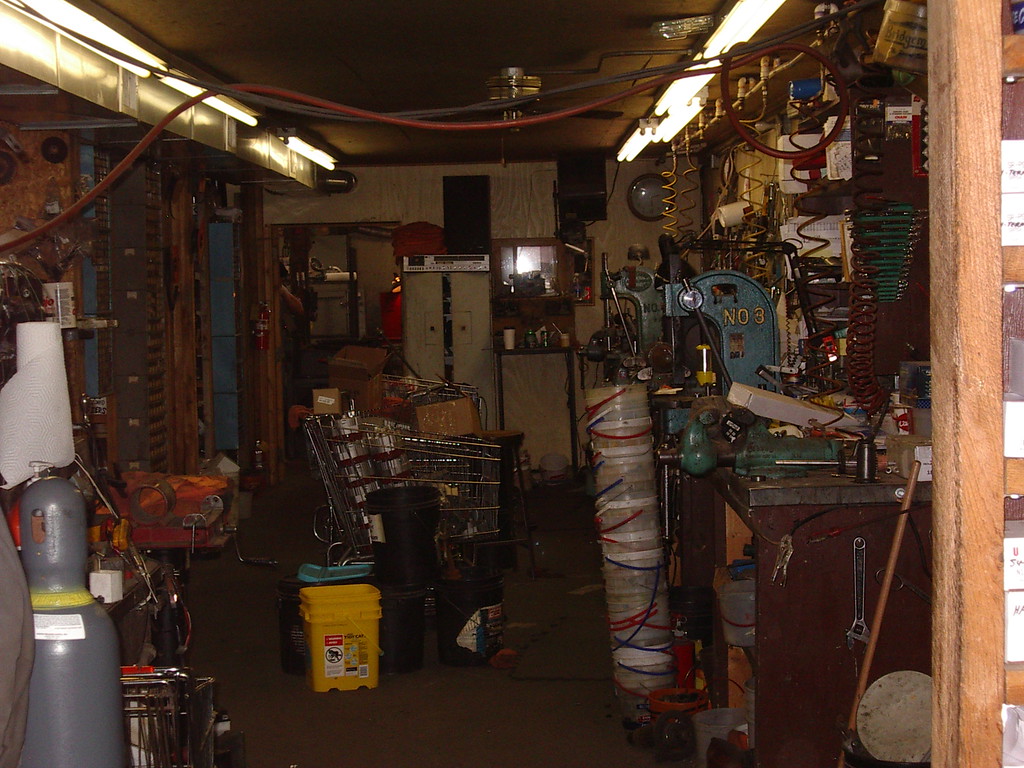

My 1988 Diesel 6.2 liter diesel outside Terry's auto electric in Bemidji MN.
They rebuild alternators, generators and starters. They do it right the first time, fast and cheap. They rebuilt the starter for my Willys Jeep in less than 24 hours for $35! They also rebuilt the generator for my 1958 JD 420 and the starter for a 1930 De Soto I was working on for somebody.
I think their rebuilds are better than new, and a hell of a lot better than Chinese rebuilds.
A real hangover of how America used to be and needs to get back to!
