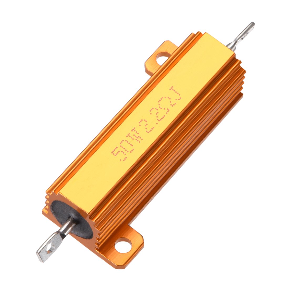

HERE's a 50 watt 2.2 ohm resistor, unless I get 25 watts.-View attachment 43080

See, this is why I don't add speakers that are the correct specs because finding the speakers with ALL the correct specs can be difficult, even if they are simple resistors to replace it gets difficult.
I would really like for you to learn more about speaker design so can understand why the bold part of your statement is looking at this the wrong way. The woofer determines the type and size of the box, whether it needs a port and the overall sensitivity (how loud it will be with a certain power input) of the system. The other drivers (midrange & tweeter in a three-way or only a tweeter in a smaller two-way) need to be balanced with the woofer. The level from these can be balanced just by selecting something that's close to what the woofer puts out, or they can be made to balance by reducing the mid/tweeter output in the crossover. This means the crossover will have resistors and resistors get hot, as I posted. There's no reducing the signal without heat. Period. The energy sent through the resistors is wasted and the only result possible from that is heat, regardless of whether it's a resistor, eating food, burning fuel, etc.
Speaker design is far from just selecting resistors.
