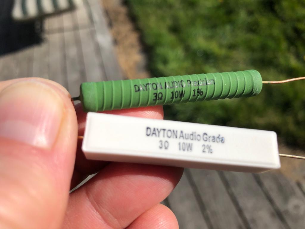

Here are two different Dayton Resistors I had close at hand:
Both are 3 ohm, 10watt resistors, the green one is 1% tolerance and the white is 2%.
