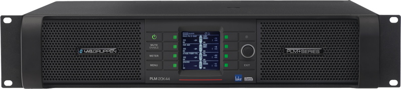

Alright just for fun let's compare SNR and Crosstalk between this $12K pro-amp vs. a cheap AVR since we know that pro-amps will beat all AVR and most amps in terms of power output.
Lap Gruppen (from manual): Gain 22dB/ SNR 105dB, Gain 31dB/SNR 111dB, Crosstalk 70dB 1kHz. So if we're talking about a typical AVR gain of 28dB, the SNR would fall between 105 and 111dB, maybe 109dB or less?
http://www.marketing.labgruppen.com/webservices/dh.ashx?t=qv&v=12010
$300 Yamaha 377: Crosstalk 77dB 1kHz, SNR 110.
https://www.soundandvision.com/content/yamaha-rx-v377-av-receiver-test-bench
So a $300 Yamaha AVR has better Crosstalk and about the same or better SNR (at ~28dB Gain) than a $12K pro-amp? :D
Of course, ATI amps will have Crosstalk of 100dB and SNR> 120dB.
