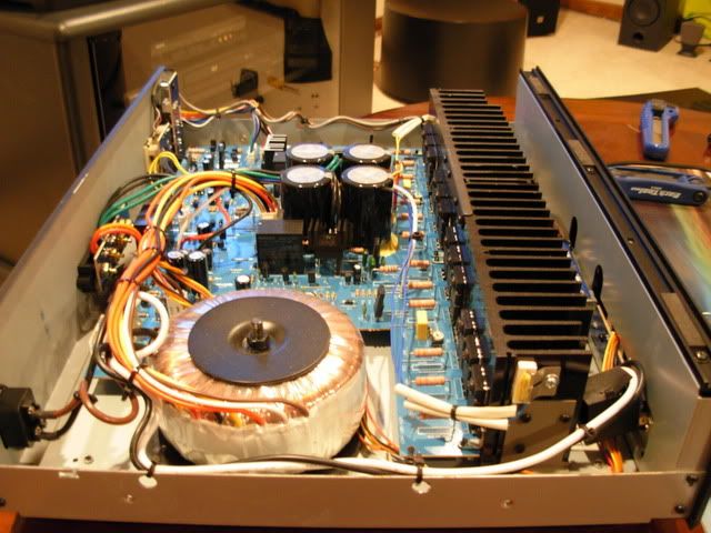

What can you tell me about this Niles SI-275 I've been using? From what I understand it uses a triple darlington output stage configuration and is dual mono. I've read a few people say that it's dark and lifeless and not really worthy of high fidelity use. Niles advertises it as being stable down to 2.66 ohms although it doesn't give a wattage rating for that figure.
Niles Literature said:
  • 2 X 75 Watts RMS/Channel Into 8 Ohms, .05% THD (Both Channels Driven)
  • 2 X 120 Watts RMS/Channel Into 4 Ohms, .08% THD (Both Channels Driven)
  • Stable Into Low-Impedance Loads (2.66 Ohms)
I'll add a picture if it helps.

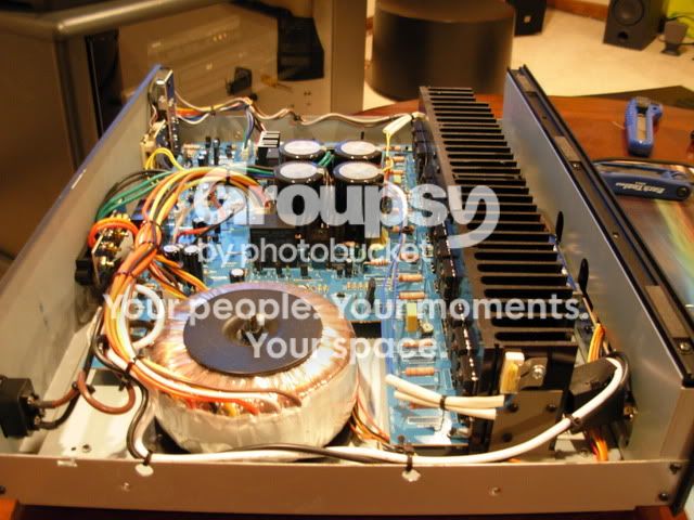

Thank you for that informative post. I'll re-read it again and do some more research. I've always been slightly interested in their stuff.
I don't know that amp. So much comes down to implementation.
What little I do know about triple Darlington output stages, is that current requirements are low, and they are good for low impedance loads.
Their Achilles heel is frequency dependent phase shifts, especially with rising frequency. This might occur in the Niles amps and could easily account for their reputation. Again this is not something that would show in usual amp test procedures..
