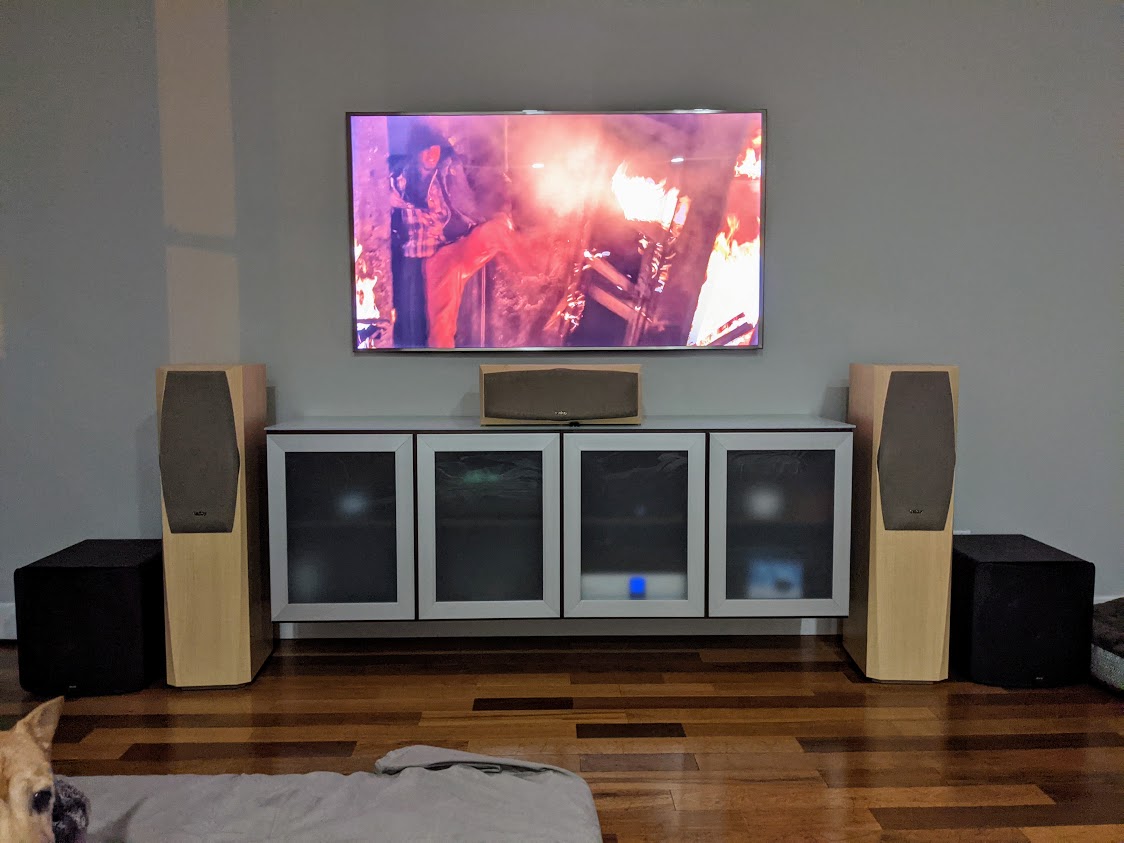

I recently upgraded my subwoofers (with tremendous help from this thread). It is now time to replace my aging Infinity ILs (IL40s f, IL36C, IL30s r). Due to the design of my room I have roughly 19" from the front of the face of the front speakers to the wall. The front speakers I have been considering are:
Obviously these are vastly different speakers (and ones that I will not be able to demo) but I am wondering if the deep speakers with rear-facing ports will run into issues when places 'close' to the wall. Am I overthinking this or is it a valid concern?

The general rule of thumb is that rear ports should be placed a minimum of twice the diameter from the wall. More is better with a generally agreed upon 18" from back-of-speaker-to-wall (standoff) distance being a good place to be, if possible.

Rear-ported speakers may load the bass a bit more through boundary gain. I don't think it will be an issue, especially if you are going to end up EQing them anyway or if you are going to pair them with a subwoofer.

Go with the speakers that sound best. 18" behind should be sufficient. As Shady mentioned, it may bloat the bass a little, but I am thinking it will be fine too. If not, you can try a little soft material or foam on the wall directly behind the port and/or even toe them slightly to manage it.

InWall is not an option - the wall in the image is an exterior one (in back, so is my back wall). Silver LCR + stands is a better choice than some of the towers listed above?
