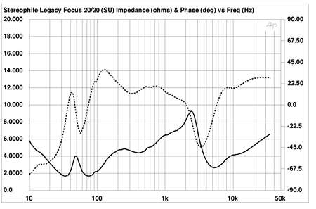

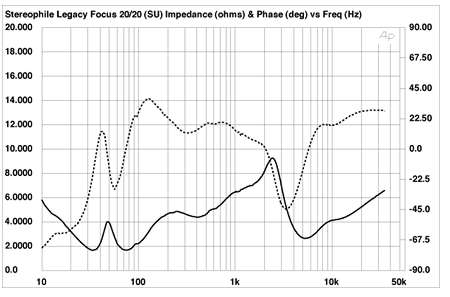

I actually didn't believe what he measured until John Atkinson measured the second generation, the Focus 20/20, and measured virtually the same impedance curve in the bass:
Wow, that impedance/phase curve is nearly catastrophic, especially below 100 Hz. To have such low impedance at such a steep phase angle in the range that serves as the fundamental for so much content.. absolutely brutal for most amps.
Like I said, the only instance I've ever heard of a distinct audible improvement from passive vertical bi-amping with a capable amplifier. The Salon2s don't get any benefit at all.
