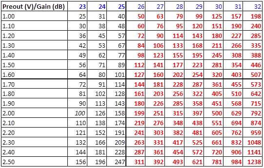

Note that even at the high gain setting, the ABH2's gain is only 23 dB, 6 dB below the more typical 29 dB. That's one reason why the noise spec is so incredible, but it is still outstanding even after factoring in the lower gain.
Note that even at the high gain setting, the ABH2's gain is only 23 dB, 6 dB below the more typical 29 dB. That's one reason why the noise spec is so credible, but it is still outstanding even after factoring in the lower gain.
Wow, I didn't think any amp had that low of a voltage gain.
So if the gain were 29dB like most amps, the SNR would probably be lower?
Not that any of us could actually hear a difference between a SNR of 100dB vs 130dB, unless we're hallucinating. :D

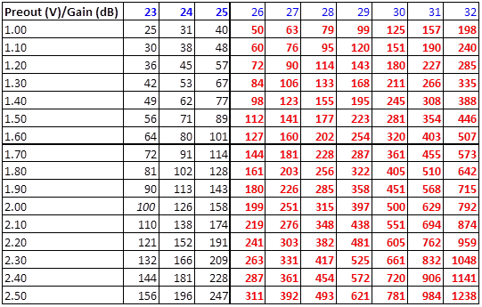

Yep, the table I posted would have to be updated to include 23 dB. For you only, here it is:
Not that bad because it is only rated 100 W, so even the 2 V rated RX-A1020 can make it, barely.:D
Anyone pairing any AVR with a 100WPC Benchmark amp when their AVR could probably output 150WPC? :D
