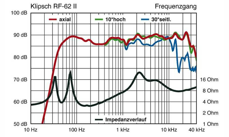

Rf 62ii measurements look fairly flat to me, despite some extra treble.
The redesign of the horn on the premiere series has eliminated the harsh sound. Most measurements of the Premeire series, including my own, do show a very slight bump of 2dB in the treble from 1.5-10khz, but they otherwise the drivers measure extremely flat with a lack of any resonant peaks among their pass band. I have some measurements from Dennis Murphy to demonstrate this, however, I do not have his permission to share them.
Sent from my LGMP260 using Tapatalk
I've measured the RF62ii, and they are not flat; they have a classic saddle-shaped response with a bass and upper midrange emphasis. I don't ever use them for music, they're too colored, but for HT use they never exhibit harshness. On the contrary, they are quite enjoyable for HT, and I consider them a remarkable bargain for $600/pair delivered.
