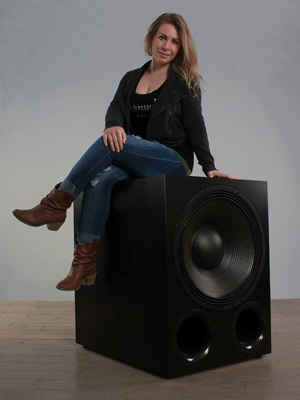

Actually, now that I think about it some more, I remember that Jim Salk built some custom enclosures for some HS24 subs and these are them.
Bucknekked
Bucknekked
Hey Buck, can you tell me anything about those subs? They look like commercial subs that use the SI HS24 driver, but the only commercial subs that I know of which use that driver are DSS subs, and those do not look like DSS.
As it turns out, yes I can. They are custom builds by Jim Salk. That is Mrs Mary Salk in the picture.
There is a thread on avs forum dedicated to Salk speakers, and they actually show the factory build on these as a work in progress. 350 to 400 pounds apiece when assembled. Jim says "flat to 5hz". Dunno about that, but all the movement passed a certain point in the build process is done with forklifts. They are real speakers, and yes, they use a 24 inch driver. Its the stuff audio dreams are made of. Or nightmares, depending on your creativity.
SALK 24" SUBWOOFERS ON AVSFORUM
just scroll down about halfway on that page and you'll come to the build process on the subs.
pretty freakin' awesome just to know they exist. For real.
