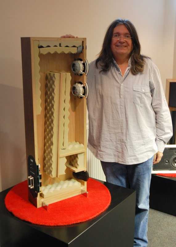

The MB2S PMC speakers you refer to here is like two stacked XB2 subwoofers, these subs are passive and around £5000 a piece so that a pair will set you back about £10k, which is about $15500, and as these are passive you need sub amps in addition.
[imghttp://www.pmc-speakers.com/sites/default/files/xb2-00.jpg[/img]
It is hard based on just these things to have any opinion about quality, and price / value proposition, but if you compare to competing brands it's certainly not winning on price. However, there's always been something very different in a positive sense with TL's and as such... it's probably hard to find better anywhere else, but the price of these things :eek:
XB2 is not their top of the line product, there's also an XB3 sub....
Even REL, that seemed to be quite pricey to mee is cheap compared to these things....
