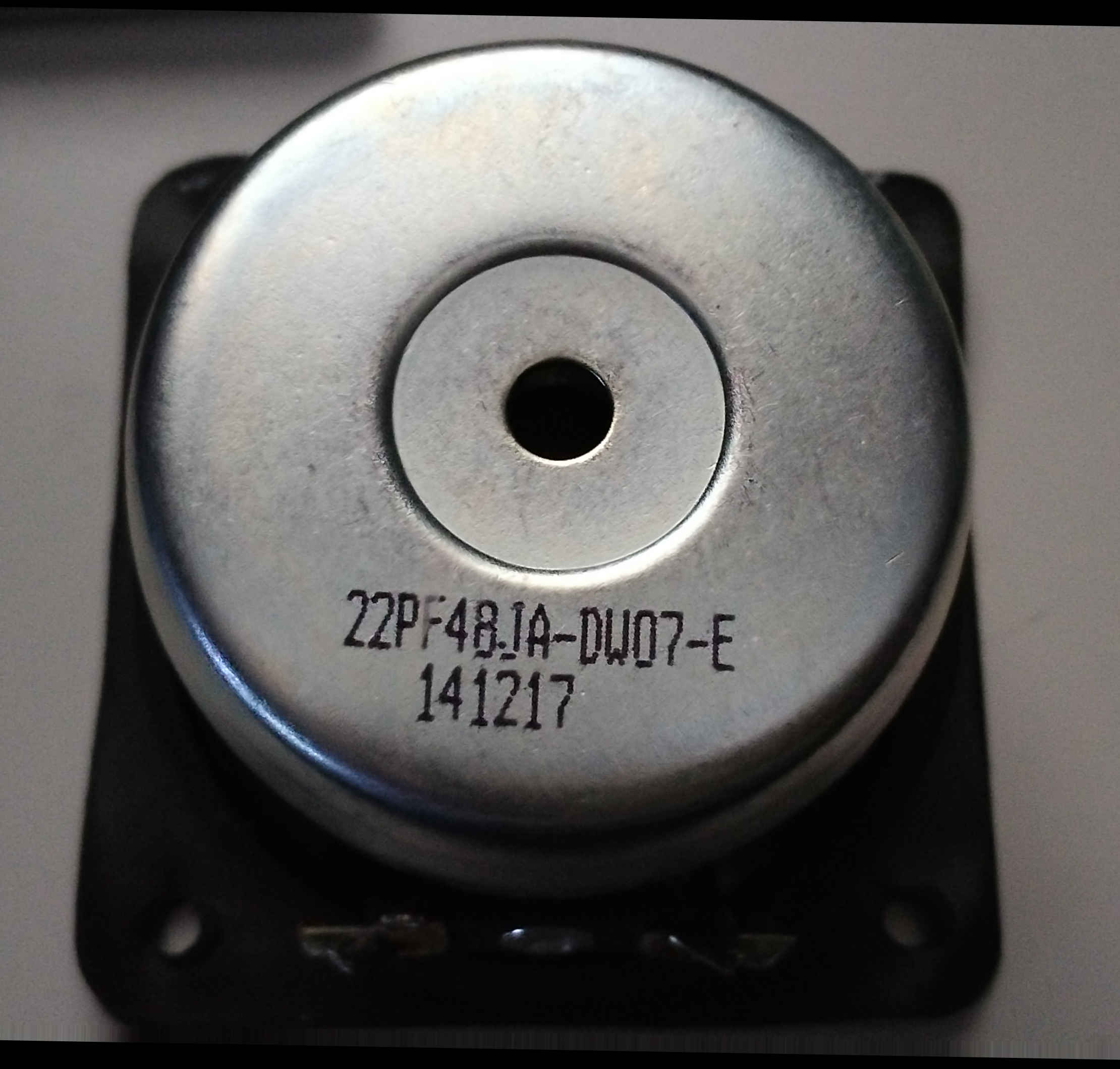

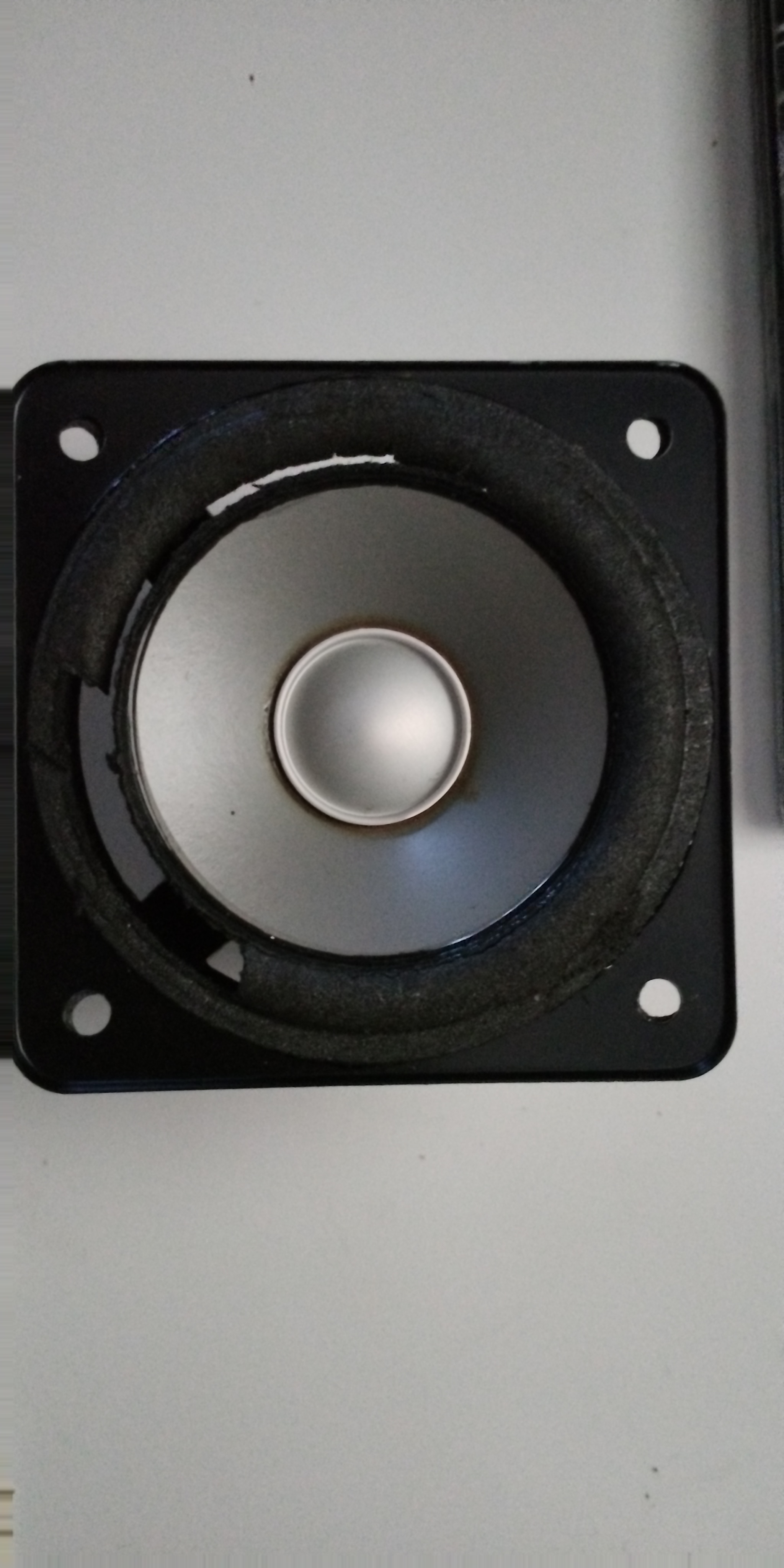

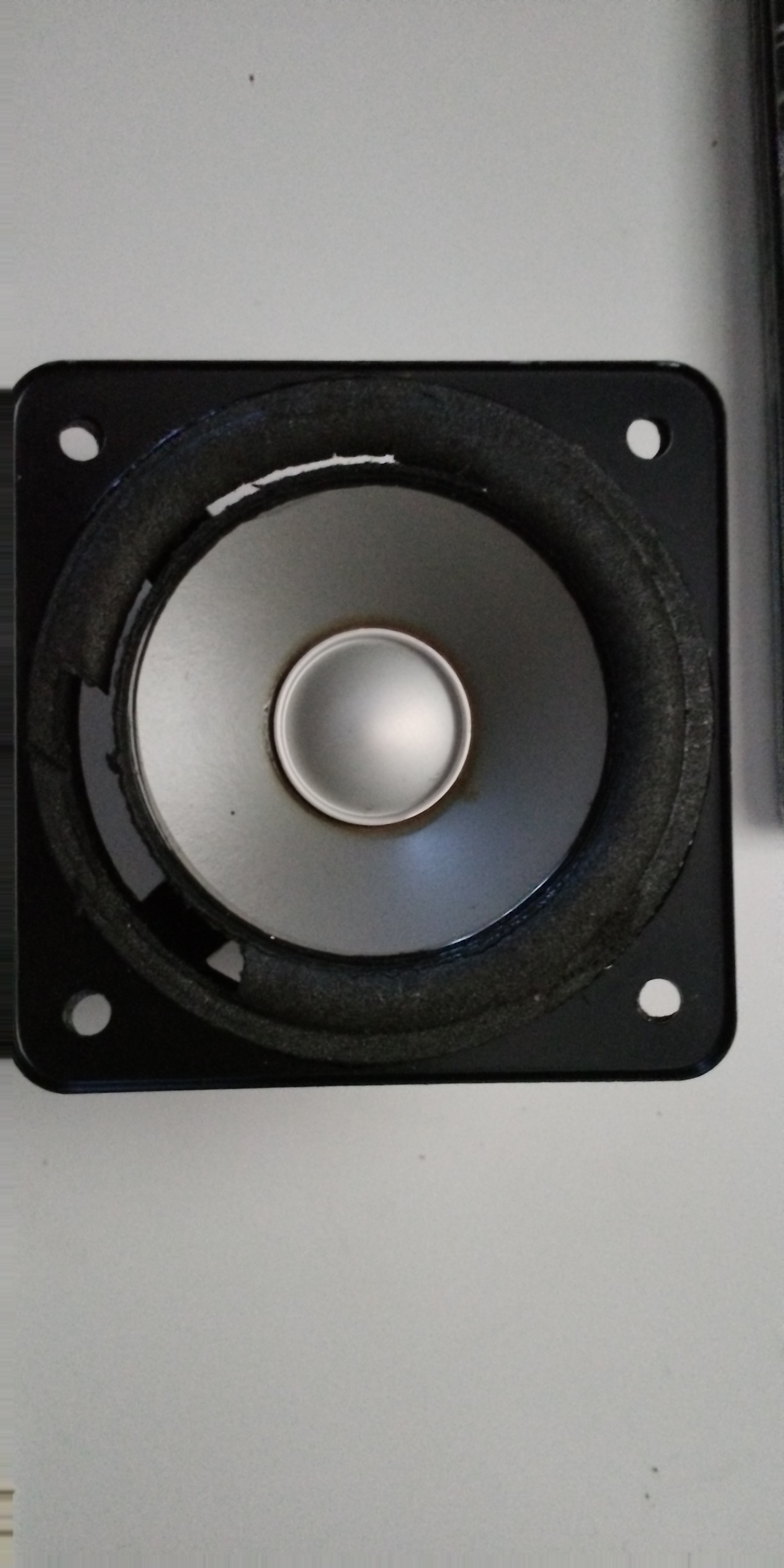

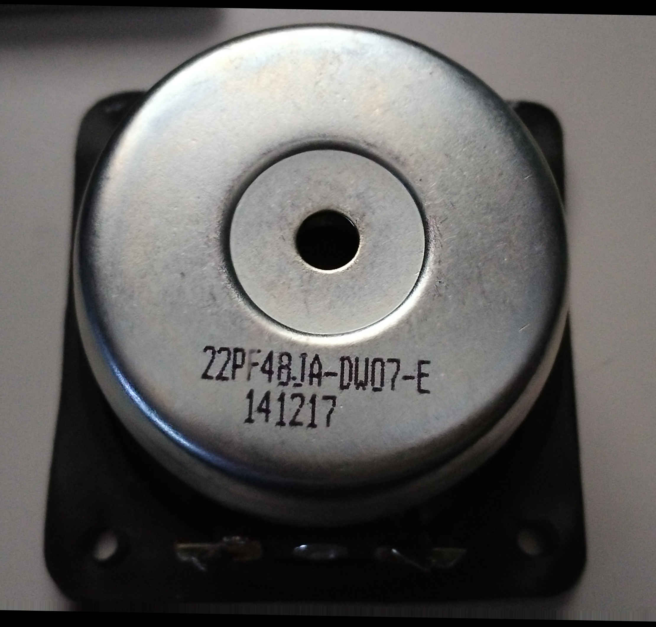

Bump! Since there is already this thread... Hi would these work to repair my JBL 2.5 speakers satellite speakers? My first time trying this. Thanks in advance.

View attachment 74054View attachment 74055
If the dimensions are correct you could potentially use them. Those speakers will be difficult to refoam, as the cones and dust cap are aluminum. You will have to carefully remove the dust caps and you will need the correct shims to center the voice coil, otherwise you will have buzzing speakers. The VC former must not even slightly touch the magnet pole piece.
I did this post on how to refoam a speaker, I did a set for a member who lives nearby.
