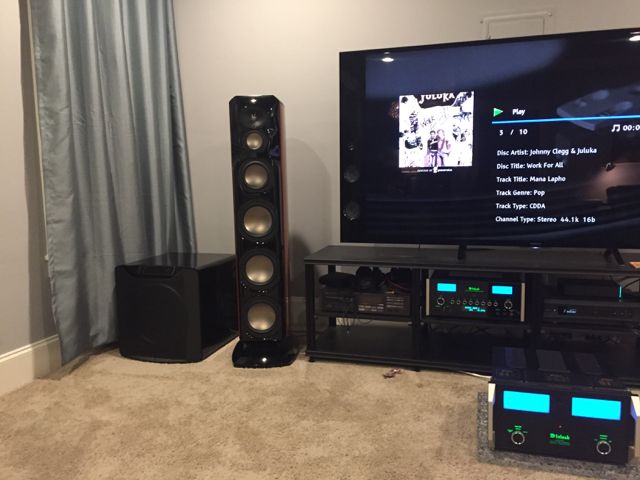

My complete chain is as follows.
My room is 3300 CF. It is treated with GIK Bass traps (4) and 4 gobos that deal with the mains' first reflections.
Amp is an MC452, preamp is aC52. Oppo BD105 is the main source. I stream Tidal as well. Speakers are Salon2s. Sub is a single JLA F113V2 with JLA CR1 handling the crossover region. I plan to add a second sub soon. (My wife is the limiting factor and keeps me to a trot rather than a gallop when i comes to adding gear). Blue Jeans cables work fine. I feel it's a waste of money to buy expensive cables, and have real questions about those manufacturers that add networks to their cables. I listen in 2.1, so no surrounds, no bespoke processor apart from what the Oppo offers. This supports a Sony XBR940C for watching videos. Very impactful as just a 2.1, as is, adding surround channels would be fun to do at some future date. I'm patient and don't mind building it out in steps.

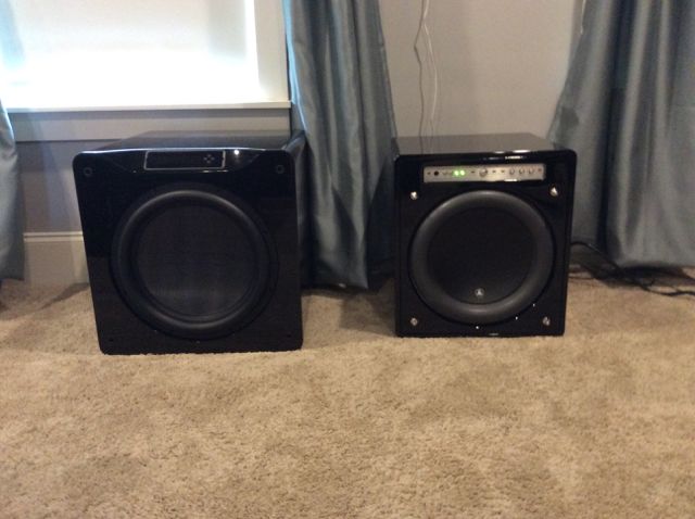

The JL sub was cleaner, with superior perceived transient response in my room. It provided clearer audible distinctions between tones and less undifferentiated rumble (on video) but a superior sense of attack and variation between both musical notes and summed effects No amount of fiddling or measurements I could bring to the party made the SVS approach the clarity of JL on music in my room. Room treatment took it all to the next level, especially "system focus" but was done after I settled on which sub to use. When doing summed bass for video, even the single JL can be startling. Much depends on integration and room placement. Getting those right makes the meal, but the results were just more musical with the JL sub. Also, although the JL cabinet is much smaller than the SVS, the driver is almost the same size. and offers like piston area. The smaller size is a plus for me but didn't go into my decision process since I do have room for multiple subs from either manufacturer.
Note: SVS was very accommodating and did not make the return of their sub into an ordeal. They were good to deal with and very responsive. JLA has been the same and I have spoken with Barry Ober, their CS guy, several times. He's been highly informative.
Since your room is bound to be different than mine, you could order the SVS once you have finished up the rest of your build and see how it integrates for you. If, like me, you find it doesn't satisfy your needs, return it with no harm lost except the effort involved. If you're happy with it, so be it. If not, go for the JLA. I'm an outlier on the SVS issue on this forum, but I know other people who have had the same experiences I did in comparing the two. Bottom line: I was surprised how much different the two subs sounded in my space.
All that said, without comparing them you'll never know but for me in my room, the differences were stark. The JLA was also much easier to optimize in my room, although if you read me all the way through you'll get the sense I never was able to really dial the SVS in with the tools it provided. That may be true, but I followed the rules for both and was open minded without a brand preference at the start.
Sub placement was decided by modeling in REW, and then doing a sub crawl. The crawl resulted in different (and superior) placement than the various REW models suggested.
My room is dedicated so "I do what I want!" That's a big help.
My rig was always planned as a music first two channel system and while I sometimes contemplate adding surrounds, I love the way it works on music and continue to drive it further forward in that direction before I move to full surround. But that could happen!

Whatever makes you happy is fine with me. The SVS was not nearly as precise for me, albeit it probably does play louder, if that's your measure. Both were adequate for me in that respect.

How did you set them up? Who's Auto eq, manual eq , or no eq. In the OPs price range id look at Seaton Sound for that room size and the new HP18s. After that JTR. The room is massive and for the price of JLs the Seatons are a steal with wicked output to boot.
In the end, I did a sub crawl. I can outline that if desired. I modeled in REW but their modeler doesn't account for certain variations so it didn't do a precise job for me. I can outline if desired.
That landed me with a sub crawl as the best option. I put the sub in the MLP and played tone through the system, crawled the room. I had four roughly equal spots, but two were impractical even a dedicated room. I selected the one that was the best logistic compromise.
The JLA has it's own auto EQ, DARO (18 bands of cut). I used it with the microphone they supply (added value ;)). To be honest, the improvements where not that significant in my MLP in the bare room. When I added the treatments, I re-eq'd and the differences were a little more pronounced. Adding treatment was fun. Big gains.
As you know, the SVS has three bands of full parametric. I used those to tune by ear. Essentially, you can't get flat bass response in a small room. Bass frequencies are too long so you're going to have nulls, just unavoidable. You have to pick the best spot and after that align to the speakers. I use an external crossover now, recently added. At the time I relied on the low pass of both subs, a compromise. My OPPO could provide a basic crossover function but I don't use it as a preamp. I use the Mc, so I went with what the manufacturers gave me. We measured with SMAART, but as you know, there are limits you need to be aware of when looking at a small room's measurements.
And that's it. I haven't heard the Seatons so I can't comment. All I have is what worked for me. For that matter, there are a lot of guys raving about the SB16, so as I said from the start, on this forum I'm an outlier. If I was looking to save money, I might look at a Swarm, and I wouldn't turn my nose up on anything I haven't tried. There are a lot of people working in the field and there are some excellent products available.
