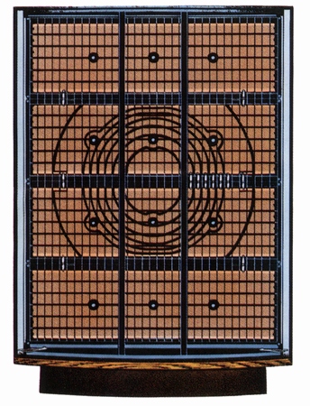

You can see full details of the Quad ESL 63 here.
There is no doubt that the Quad ESL 63 is one of the world's most accurate speakers. Peter analyzed the behavior of a thin stretched plastic membrane. Of course sound will pass through that unaltered. In a way you can regard it as a perfect speaker. By studying how the sound moved through that stretched membrane, he was able to closely mimic the effect with those delay lines, and this drastically improved the radiation pattern.
The biggest limitation of the electrostatic is power handling as if it is over driven, then sparks puncture the plastic membrane requiring a rebuild. So there has to be drastic power limitation which is immediate and obvious if power is exceeded. Since the ESL is not that efficient then spl. is limited.
Quad ESL 63
Peter's intent was to produce a very accurate speaker as a yardstick to assist in the design of more conventional speakers, including his own. I think he achieved this goal without question.

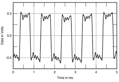

These Quads are the only speaker I know off that can reasonably reproduce a square wave.
