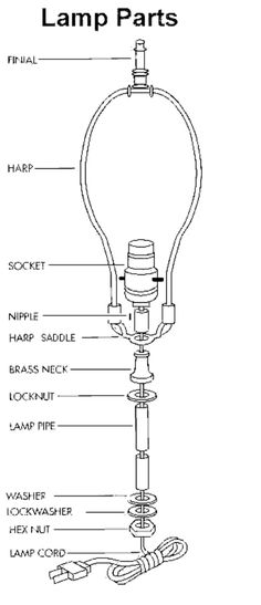

The exploded diagrams (below) show two ways to use a long threaded tube that require some extra parts that might be more easily available than a special tool. The first diagram shows a long threaded tube and a base that fits on the bottom of the lamp. My Italian lamp had no base.
The second diagram also shows a long threaded tube, plus two long sleeves that fit over it. That would allow me to thread the nut and tighten it without having to screw it up the full length of the tube. That would work! Thanks. Now, where can I find those sleeve tubes for the next lamp?
